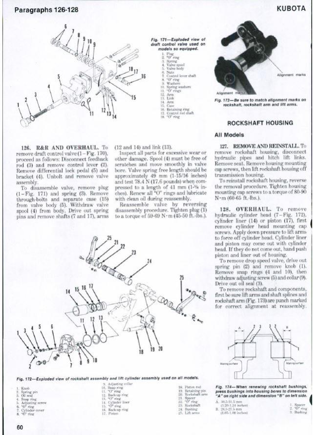

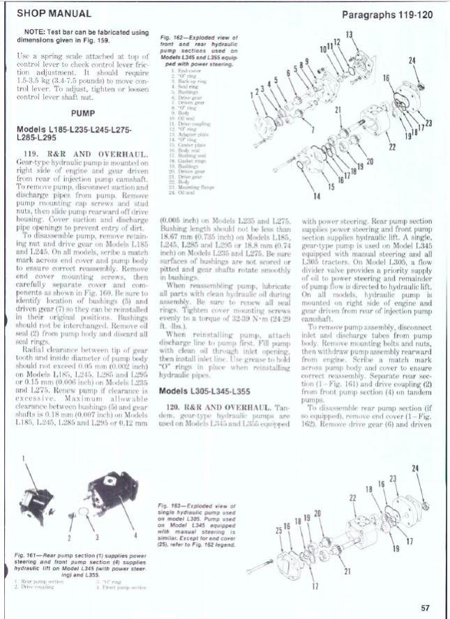

Possibly something wearing out, but attached are the L235-L275 Owners Manual Hydraulic pages.....

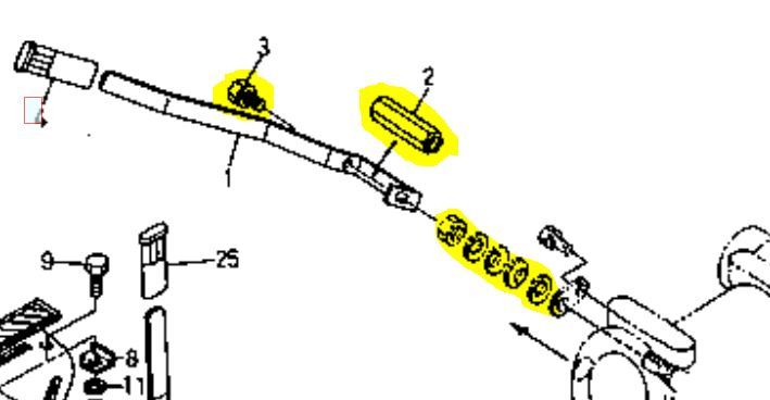

If the lever isn't staying put. Then the issue is a simple adjustment ;) follow the level down. There should be a a couple nuts and crush washer, or plastic bushings. Should just need to adjust the tension for the lever.
The adjustment is down at the bottom of the lever. Near where it ties into the transmission.
