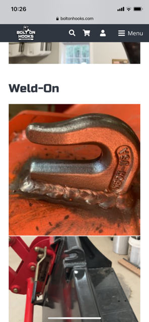

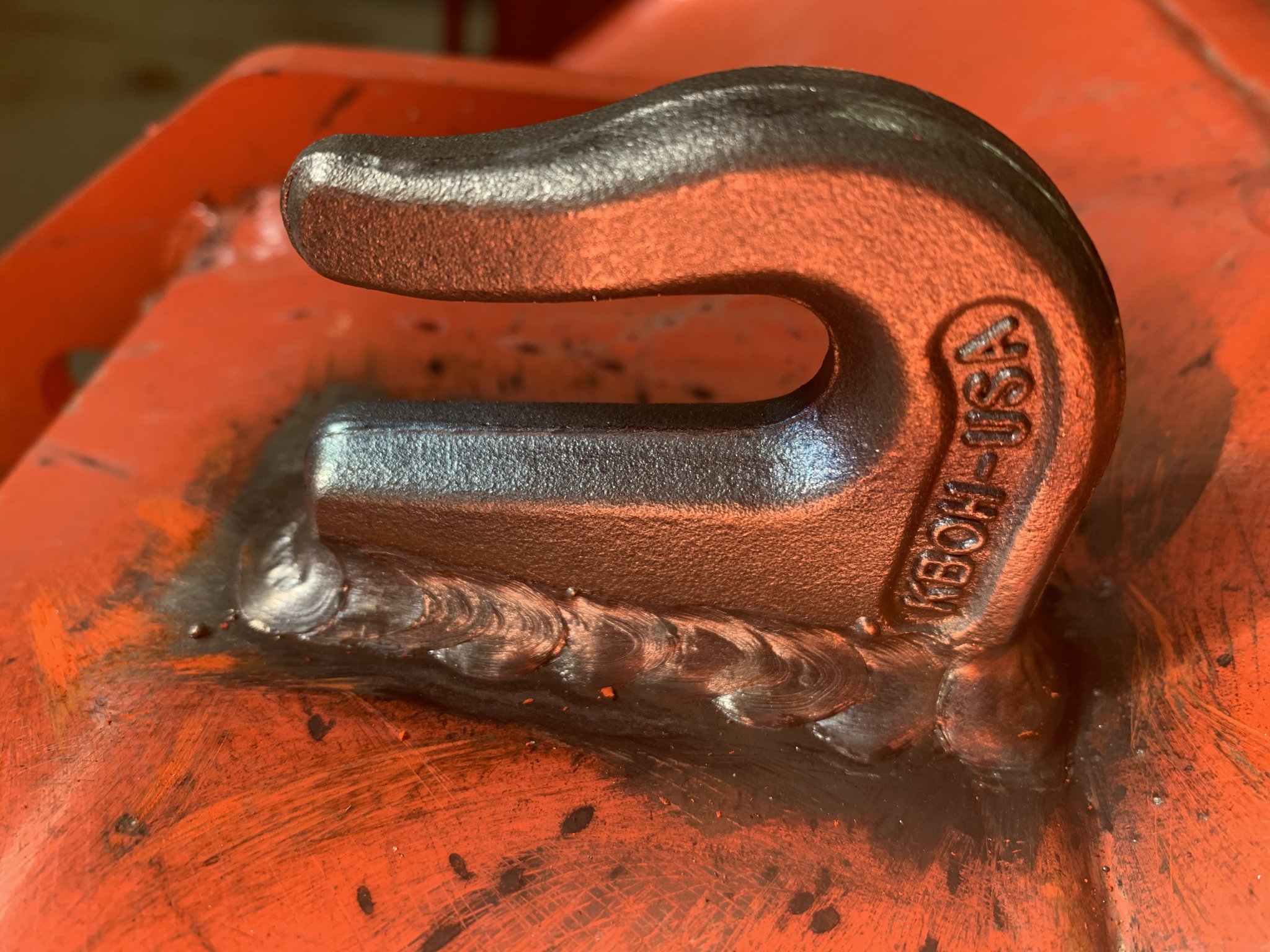

Note we sell weld on parts too, in fact our 5/16" and 3/8" hooks are the ONLY grade 70 weldable hooks forged here in the USA. We have a video on out YT channel showing the 3/8 ones getting forged.

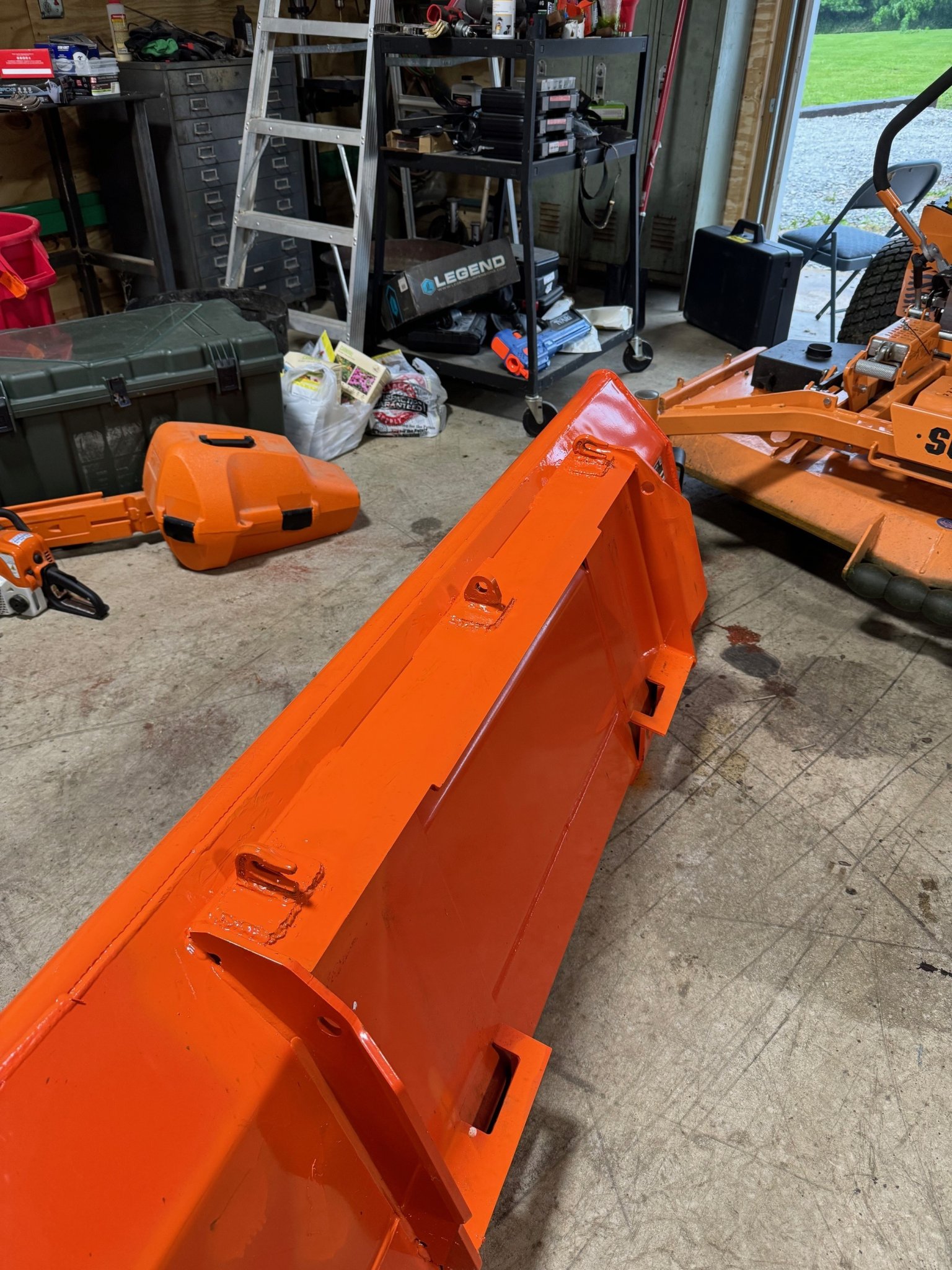

Hey Kenny, do you think i can use the weld on hooks in the spots that i have indicated in the picture without any issue? i was just trying to keep those hooks in line with the cylinders

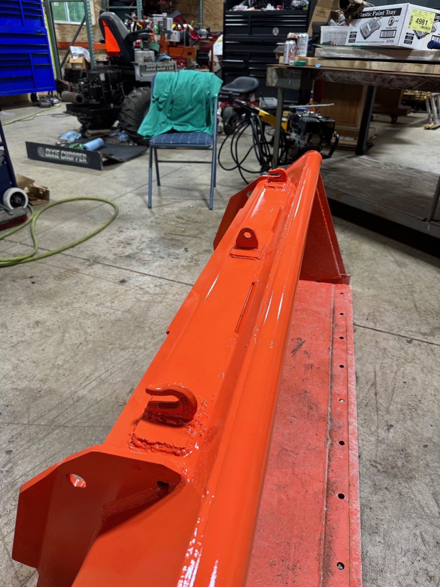

well, i got my hooks installed! dont laugh at my welding skills. i am pretty sure they will hold though. LOL
