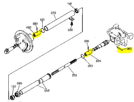

Do you have the drive shaft exposed so you can see the couplings?
Sound like you have one that is stripped.
Drive out roll pin (060) and remove bolt (090) and slide the 2 halves of the propeller shaft cover (040, 070) together and inspect the couplings (020) on both ends.
You might need to drive one of the roll pins (030) out and remove the shaft to inspect.

Ok I took the coupling loose from the pinion gear shaft, when I lock it in 4-wheel drive the driveshaft will not turn when I take it out of 4 wheel drive the drive shaft will turn. When I hook the driveshaft back up to the pinion gear shaht I turned wheels in the wheels turning opposite direction but the pinion shaft going into the coupler does not move but I hear gears skipping it sounds like it's no engaging somewhere in the front axle I guess. When it's locked in four wheel drive should the wheels be able to turn when it's up in the air?
That sounds perfectly normal, as the transmission is engaged to the rear wheels so you shouldn't be able to turn the shaft.
I think you get the misconception that something in the front axle locks in to put it in 4wd, nothing in the front axle changes between 2wd and 4wd, and the propeller shaft turns both in 2wd and 4wd.
It's only the rear at the transmission that changes.
Now if you turn the pinion and your getting a bad clicking, knocking, or grinding that's not good, but a gear whirr or slight chatter of gears is somewhat normal.
Yes, like whitetiger said, they will turn in opposite directions.
