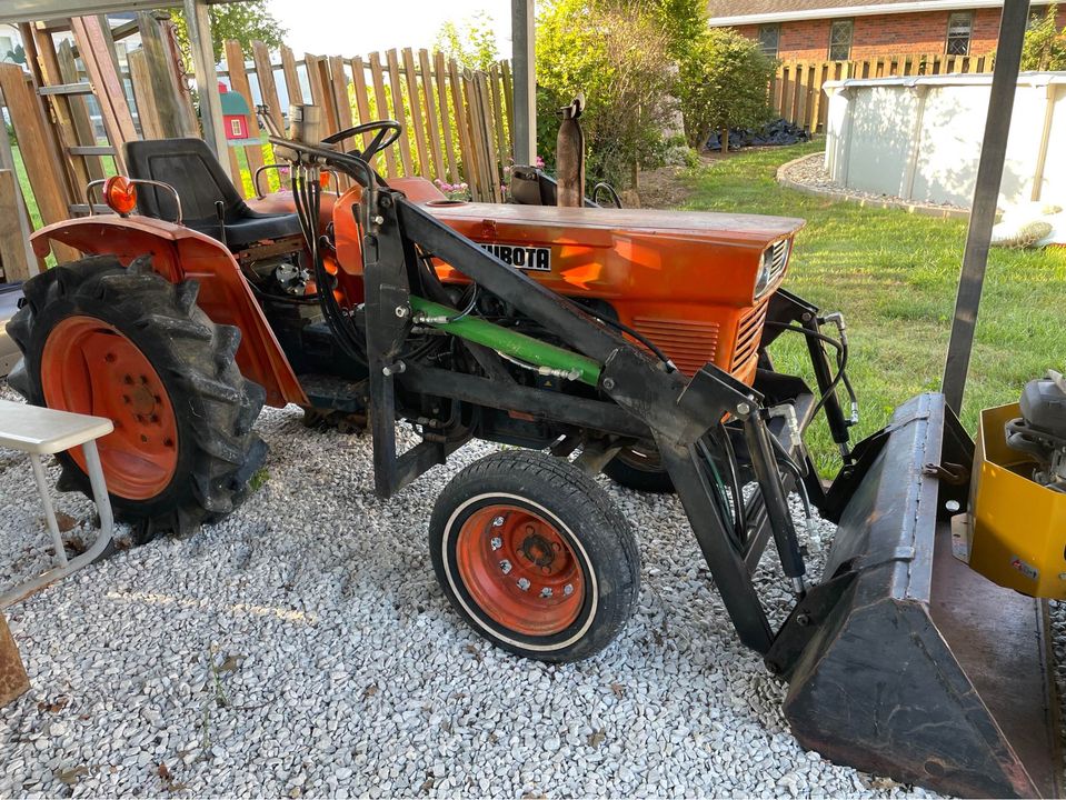

I have a 1976 L225 Kubota with a loader attached. Is there a way to replace the hydraulic hoses and add quick disconnect connectors so I can take off the loader when not using it? It needs many of the hydraulic hoses replaced anyways. Do you think the tractor pressure would support the connectors?
Thanks for the help
6,243
1,930
Yes to both questions.
But how difficult is it to remove the loader? Do you have a way to store the loader or does it have some built in legs that hold it in a position where it can be removed and re-installed?
Does the loader valve stay on the tractor or go off with the loader? That will determine where you want to install the disconnects. Your tractor probably doesn’t have much flow rate unless there is a separate pump which is not obvious in your picture.
You may want to get fittings and/or adapters to get hoses with JIC 37 degree female swivel ends that are easy to install.
A few hoses (5-6) will run into 2-3 hundred dollars depending on length.
33,304
8,648
You can not simply disconnect all the lines, you must keep a loop from the pump to the Power beyond/ tank open or you will dead head the pump.
This is done with either a loop of hose or male /female on the pump output and the PB input.

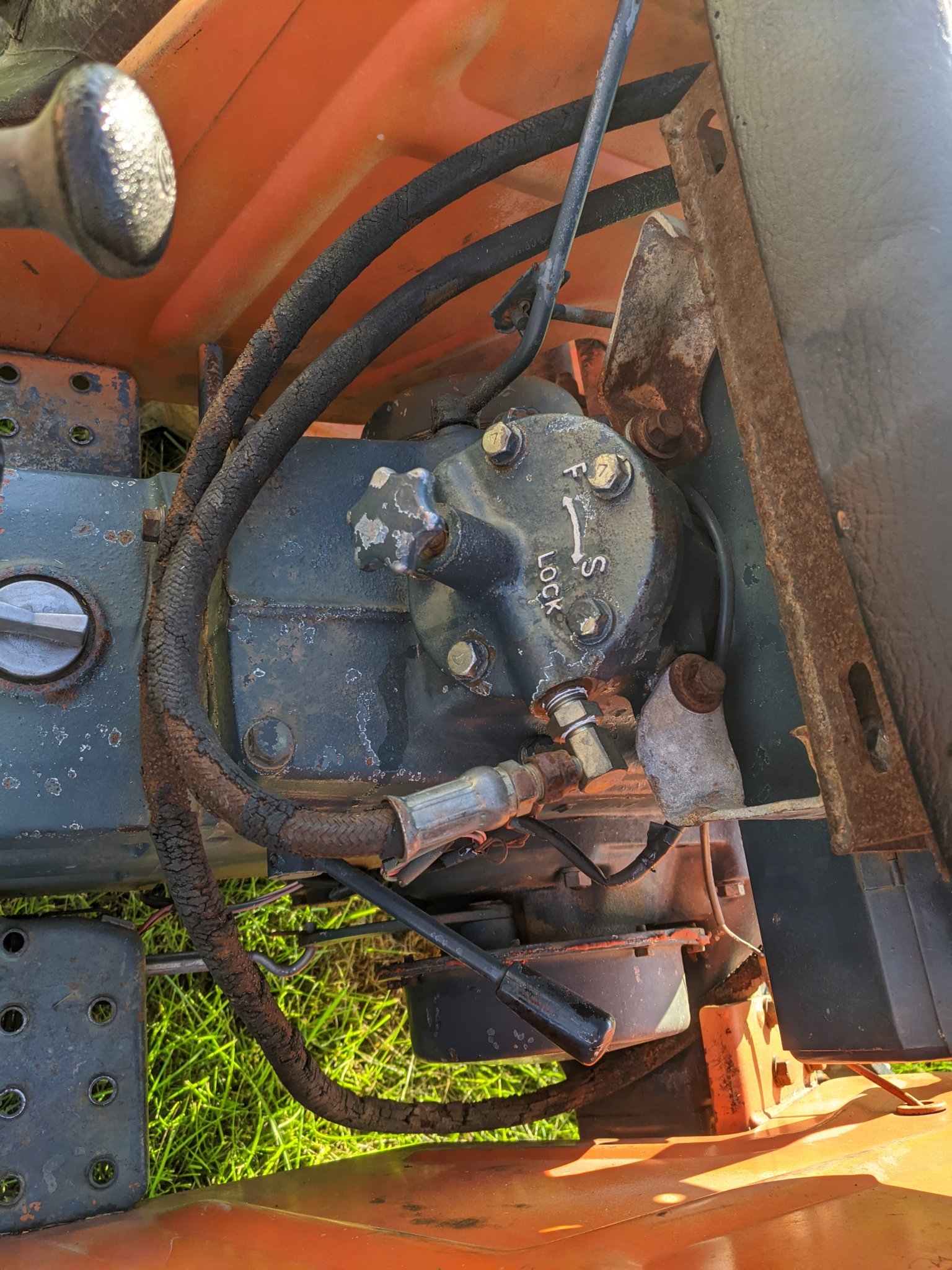

Also trying to figure out what some of the hydraulic hoses should go to. Here are some pictures.
6,243
1,930
Well that is something…
It looks like there is some sort of rear connection point that is half connected. The one disconnected hose end would probably be connected to the tractor or valve somehow and used to get fluid to the disconnect. The other disconnect would be return oil from the implement that is dumped back through the three point system into the tractor sump.
I would think it was used for something that had a control valve like a log splitter.
33,304
8,648
That is someone's hack at getting a single action cylinder to work off the three point control.
The line that is not connected to anything would have went to a fitting on the oil fill port in the back.

Someone has been hacking the hydraulics. I think you need to post some more pictures showing how rhe loader valve is connected to the tractor.
I am just going to remove all the back hydraulic extra's on the tractor and put a plug where that comes out from the 3pt. Does anyone know if this plug is anything special? The part number needed is Kubota 34150-27590 and Kubota 04714-00300 for the gasket. Could I just get a metric bolt to go there with a washer?
9,700
5,121
It is a BSPP plug not meteric
The the threads in the port were also BSPP until Bubba jammed a NPT fitting into it. You need to get a BSPP plug and washer then hope the port threads have not been damaged beyond use.
