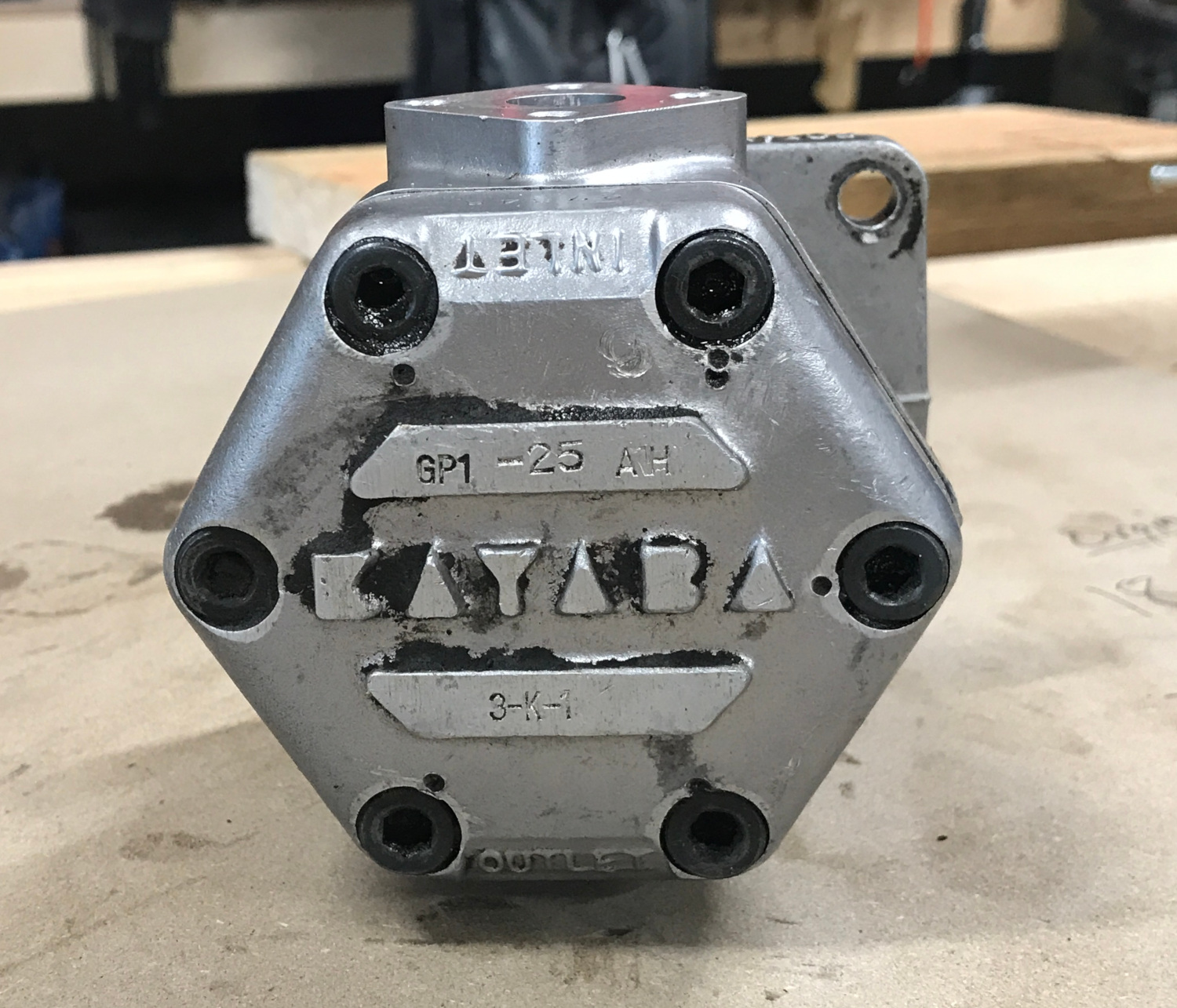

Yes, the OEM pump must have been replaced some time ago. When I got the tractor two years ago it had a KAYABA pump. This pump did have signs of cavitation on the outlet port. The hydraulics also exhibited the same behaviour I'm describing. So I replaced it with :
- 34150-36100 New Kubota L175 L185 L1501 L1801 L225 L2000 L2201 Hydraulic Pump, which shipped from whitehorse tractors in Winnipeg. @ 3.8 gallons per minute.
I installed a new inlet hose and new clamps with this pump and it worked great. A year later I am back with it not working again, so I got another one of the same pumps and installed it thinking that would solve the problem. This time it did not solve the problem, so it seems that it's something else now ?
So, one year with the original pump, then one year with the replacement. Then this problem.

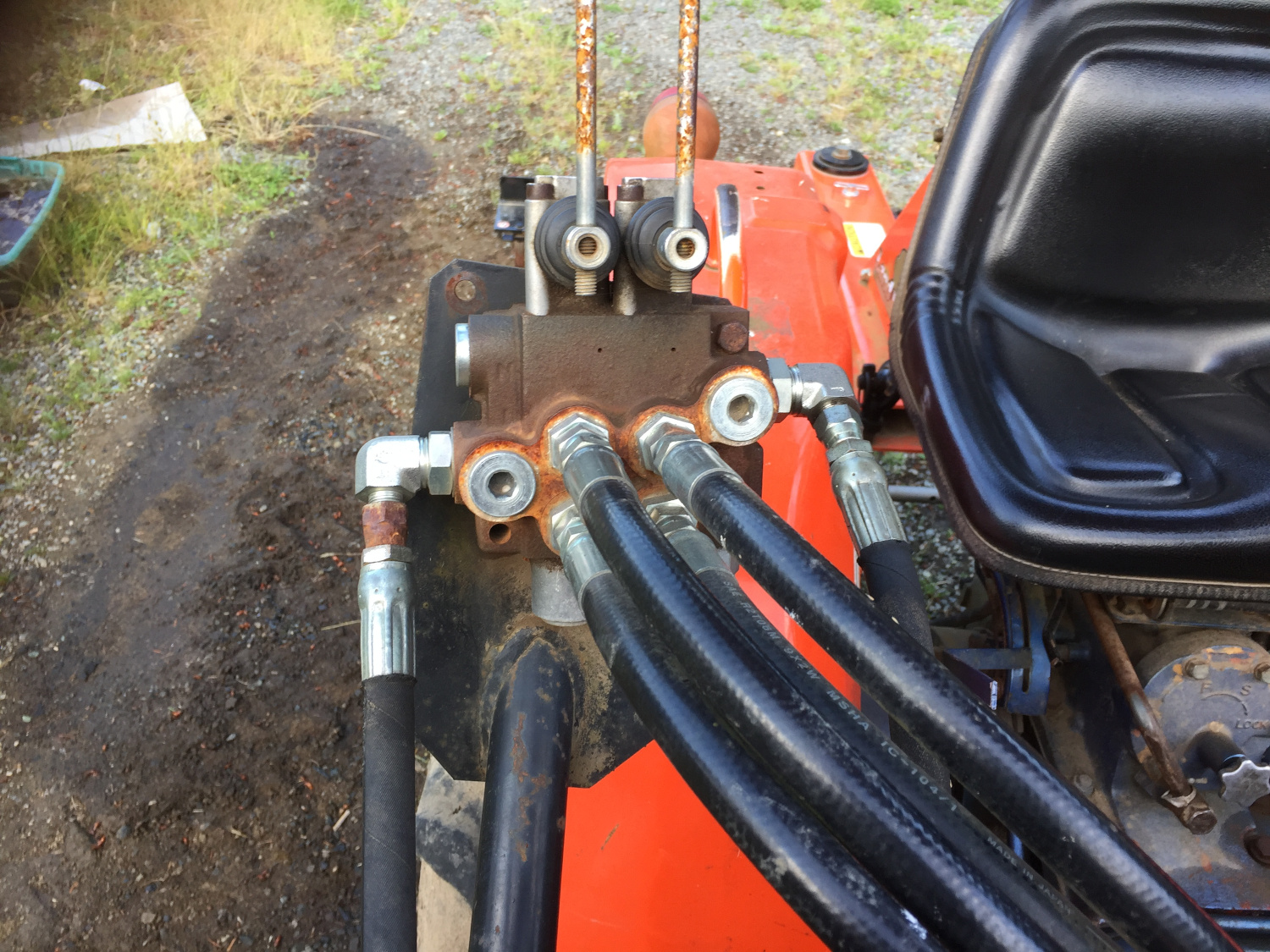

Some photos of the block and the loader valve please.

I am assuming your tractor has a hydraulic block and that is where the loader hoses connect.
Could you please take a photo of this area.

Can you make a simple sketch showing where the main hydraulic lines go.
Not the 4 to the FEL arms and bucket but the other lines feeding the loader valve and the 3 pt.
I would have expected to see 7 lines on the loader valve one of which being a power beyond line.
