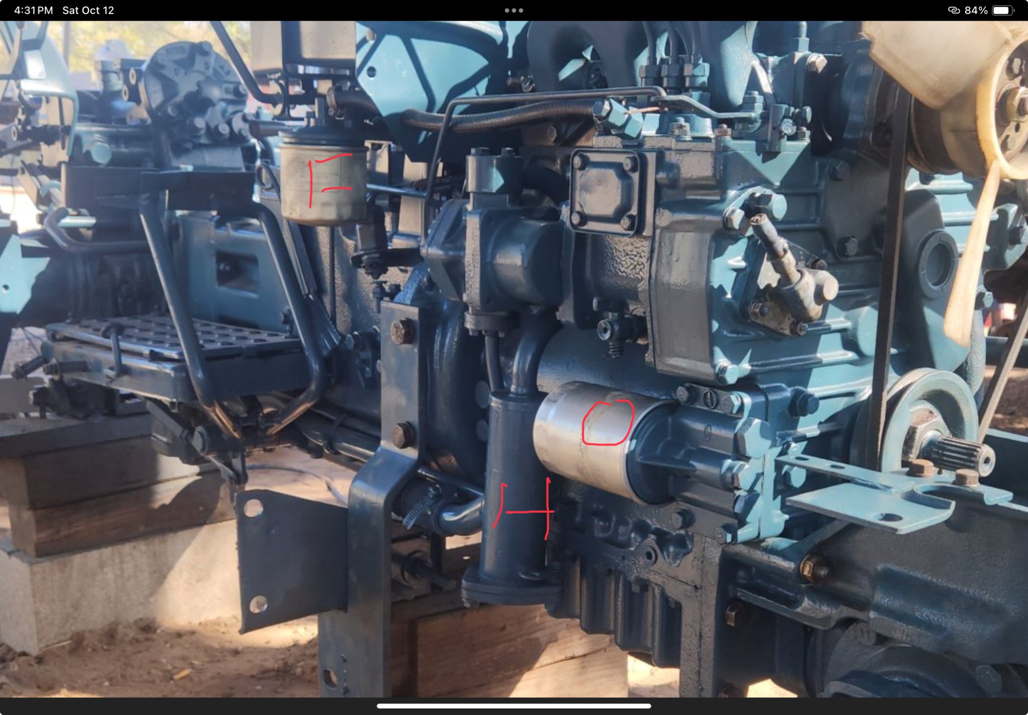

In this picture of a L295 I see three filters and crudely marked them:
F is the fuel filter
O is the engine oil filter
H is the hydraulic fluid filter (canister filter type) as I understand it.
