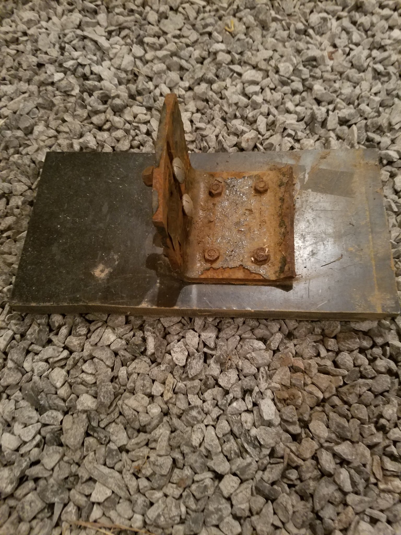

Snowblower shoes have many variations. I made mine longer/wider here:
I lined them with UHMW here:
