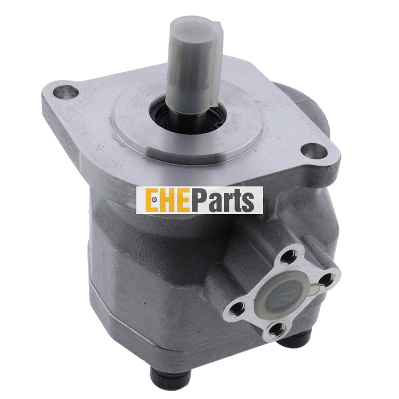

And here is a cheaper option for the pump:
