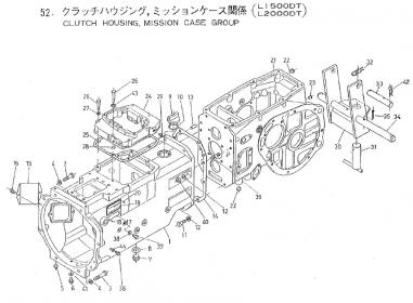

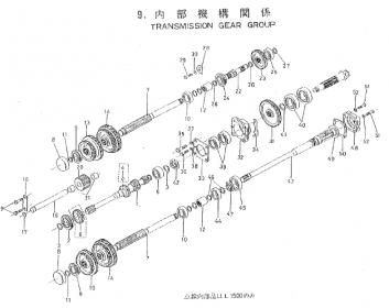

Hi Guys,
I inherited an L2000 that had the gear box stripped down. I have finally sourced the required parts to start putting it back together but would like to make sure I am putting together correctly.
Is there a parts breakdown on the L2000 gearbox? I have the L225 but would prefer the right one.
If anyone can point me in the right direction I would really appreciate it.
Cheers
Richard

It's highly unlikely that you will find a WSM or any rebuild specific info for the L2000.
Richaur
L2000DT
Mar 11, 2016
Salt Ash
Thanks Bill.
I was able to pick up a Japanese parts manual translated it was good enough to put it together with.
Any idea what the cutch pressure plate clearance is suppose to be?
I put a new clutch plate in but not enough adjustment in the Clutch - Looks like I need to adjust the Pressure plate.
