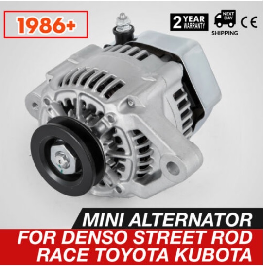

It is an alternator with an external mechanical contact points style regulator. Its output would be around 15 amps or less.
Unless you are committed to maintaining your tractor in a pristine original condition switching to a DENSO one wire alternator is the most practical solution. You gain a more powerful alternator, 70 amps, have no more mechanical regulator, loose the warning light but can easily install a voltmeter. Wiring changes are simple.

The alternator I showed in the eBay link would work easily. Some mounting fiddling might be required.
All wires connected to the existing alternator would be disconnected and their ends insulated.
The existing regulator would be unplugged and removed or left in place.
A 8 gauge stranded style automotive wire to be run from the new alternator to where the battery cable connects to the starter solenoid.
Finished. It is far simplier a wiring project than anyone expects.
Those that have done this conversion have been most pleased. Now they can run a lot of lighting and the reliability of the 2020 style product far surpasses the OEM unit.
