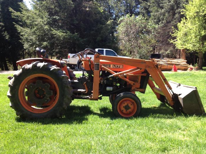

Can some of you l175 owners out there tell me the mower models you are using? I have a new-to-me image.jpg l175 with a fel on it and need to cut about 3 acres. Everyone has an opinion on what it will handle but what have you guys used or seen used that actually worked? Right now I'm looking at a couple woods rm59s and a land pride at2560. Any help would be greatly appreciated. Dave

Easiest option is to put a rear mount finishing mower on it. Alot faster to hook up and dismount and put another toy on. A 5 foot finish mower would be ideal

So that at2560 land pride 5 foot finish mower would be ok? Land pride lists its weight at almost 650. I was just afraid of it being too heavy. Thanks again

Don't know no Edward. Lol Weight wise, I was worried about the limit for the three point hitch since i haven't been able to find a max lift limit for it.

I used a 5' bush hog behind my L185 for 30 years. In really light grass I could do 4th gear, normally 3rd gear, going down to 2nd for heavy grass or 1st when the grass was Really heavy. I was a fool, most of the time running 1000 PTO speed. At 540 PTO I probably could have done 2nd, 3rd and 4th. As it was, it took a day and a half or two days to do 10 acres.
The real truth is that the 5' bush hog was too big. The tractor only put out about 13-1/2 PTO horses, not a whole lot to drive the bush hog and the ton of tractor. You could try the finish mower - maybe it will work OK.

i had a L1500 same tractor i had a 5ft king kutter the worked great but got light on front end i didint have a loader, and i have a 4 ft king kutter brush hog and that works great.
then for the last 6 years i had a set of 3 jacobsen reel mowers, highter maint but much better cut and burned less fuel,
