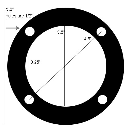

Unfortunately it's a 4-hole pattern with a 3.5" hole in the middle. I measured it out and made a template. i'm looking to have someone cut a support ring for my front rims - one is cracked around 2 of the bolt holes.
Sorry, I guess I missed that from earlier in the discussion.

Dropped the rims off at a local fabrication shop. They said they could cut a 3.5" hole no problem. Should be picking them up this week. I'll get a pic once they're on the tractor.
