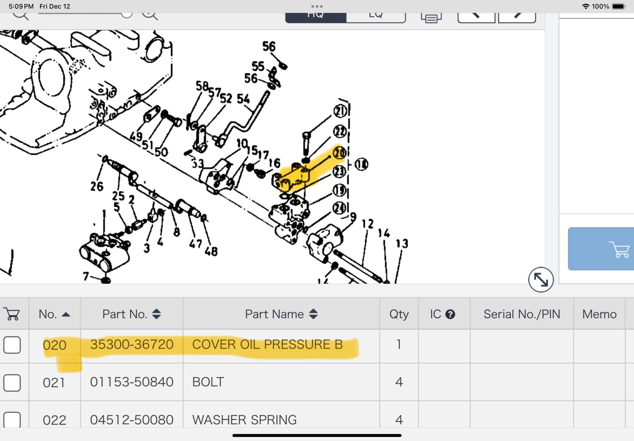

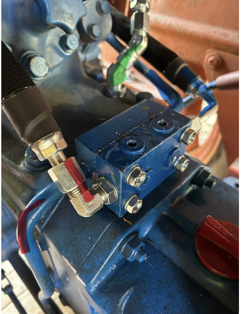

Hello purchased a Kubota recently and had my first issue it is a 1980 l345dt with a L1720 factory installed loader with an external crank mounted pump.
The external hydraulic pump blew the shaft seal. Seems the shaft key came loose and came in contact with the seal and retainer clip. Pulled it off and I looked far and wide and managed to score as far as I know the last known seal kit for this particular pump from a dealer in Michigan.
The question I have is the whole set up is worn and I may manage to pull a few more years out of it If the rebuild goes well, has anyone upgraded or mounted a more readily available Hyd. Pump to this setup? Or something similar even if a bracket modification is required.
I will machine and rebuild the shafts on both ends as both are in bad shape. all parts as far as I know are discontinued it is short of a miracle it held as long as it did.
