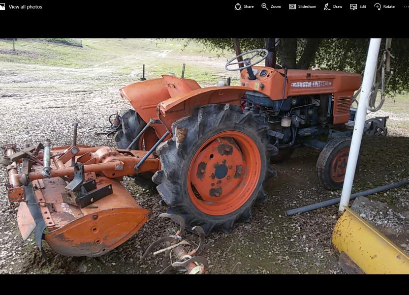

Hi, Adam 12.
glad to see your thread
I bought same tractor 10days ago.
It is runs good except reverse function and steering.
so having so much questions on this little tractor same as you.
I am replacing reverse gear and complete steering assembly in a month.
Hope we can share some information each other.
cheer
