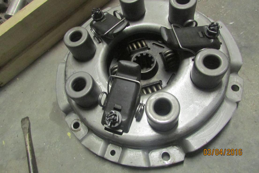

This is a photo from rbrown7713's post on clutch of the pressure plate
This is what the "fingers" on mine (installed) look like

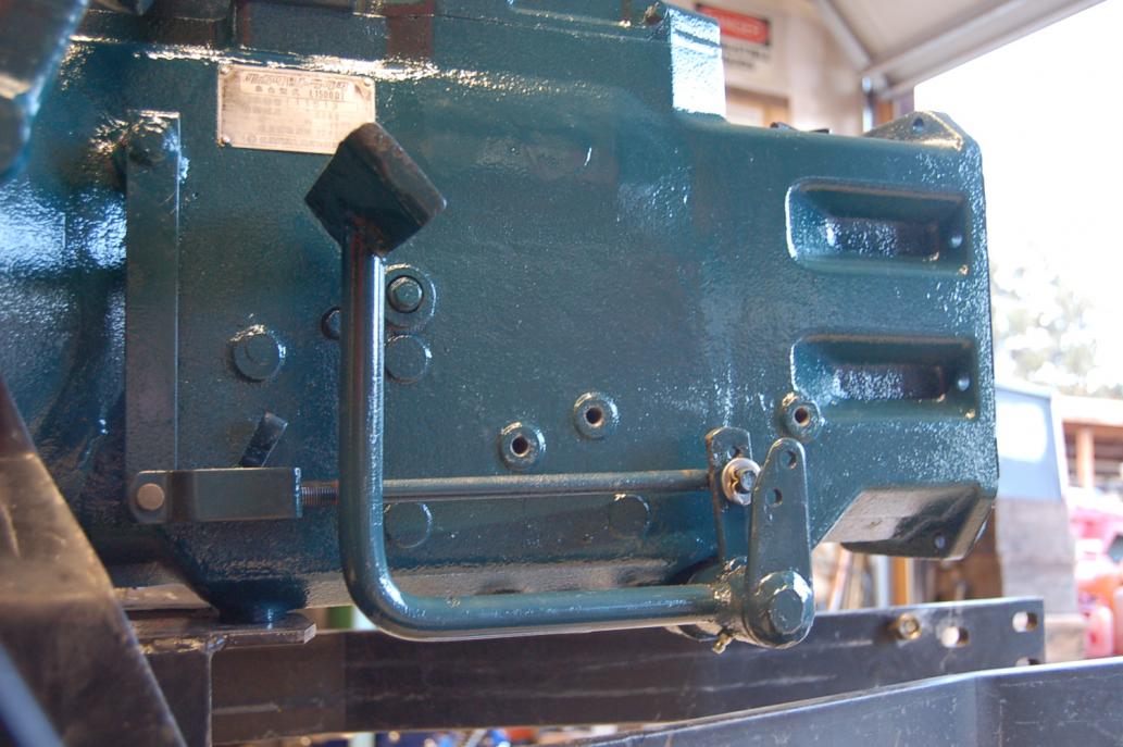

This is clutch lever position before dis-assembly
and after re-assembly

It is a support gusset, about 1 inch by 1 half inch, If you look at the PP finger photo, it looks like they are not seated properly, not sure what would cause that. That is causing the throwout bearing to be in a different position also causing the pedal to be in a different position than when it was disassembled. Therefore it hits that support gusset.
But I think the pressure plate is the problem.
