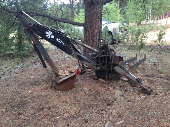

I am wondering if this setup is too big for a 1500DT
Found it sitting idle, owner not around to ask if he wants to sell?
It is a Brantly Manufacturing Company MD-8 (8' Back Hoe).

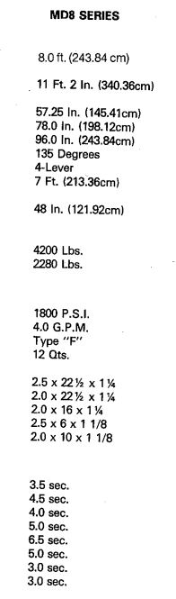

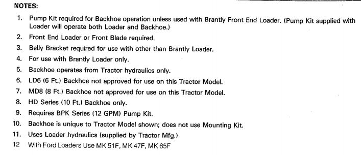

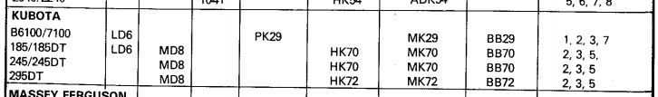

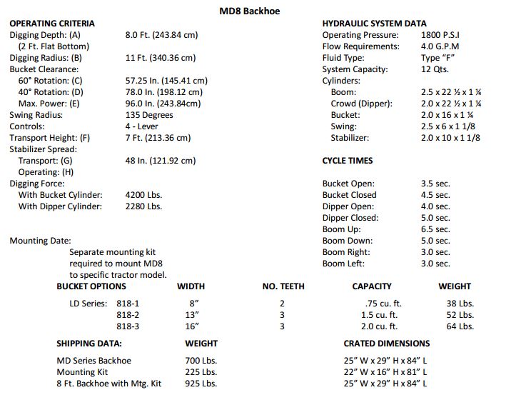

This is the information I have found.....
Kubota Applications and Notes;
Specifications;
I think I know the answer, but need you alls professional opinions
