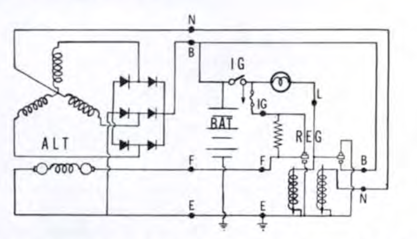

I found the WSM for the L175 which is pretty similar. It has a good diagram of the alternator and regulator wiring.

Another possible issue is with the mechanical regulator. If the points have gone bad, then too much current could be allowed through the field coil, indicated as a voltage rise.
Not knowing if the regulator is original, it could be possible that the existing regulator has an adjustment setting underneath it.
Besides a direct replacement of a mechanical regulator, there are many solid-state replacements.
Good luck with your project.

Thank you!
I'm reasonably sure it's the original regulator. I'll try to get some time to strip it down and check.
