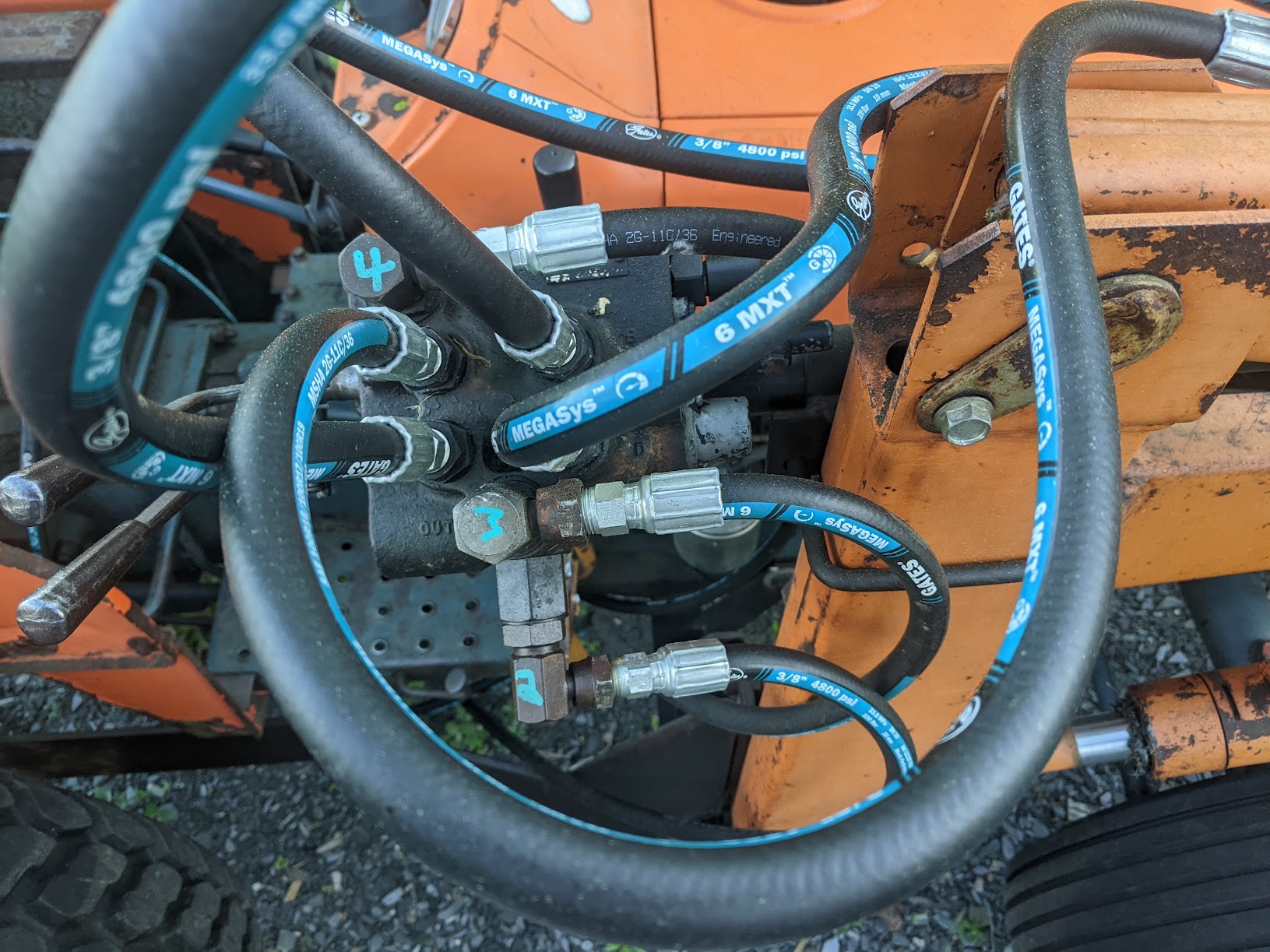

Controls:

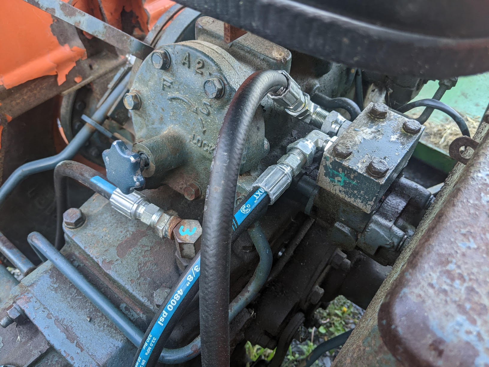

Pump:

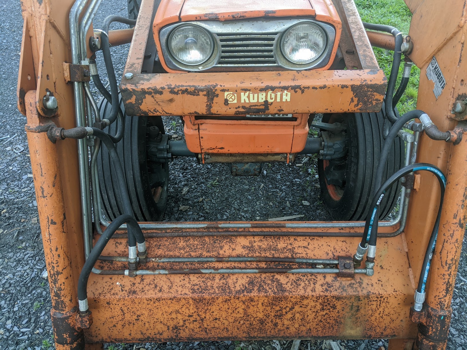

Bucket:

Does the main pressure line flex when you try to raise the boom ? I think you have it labeled as #4. If it does try to move then that indicates it is pressurizing, which is good. In which case you must have two lines swapped, if it does not, then it is on the pump side of things.
Also see if any of the other lines flex when you try to move something.
chriscraw
L245DT
Jun 11, 2022
Central VT
Yes, #4 (labelled IN on controls) does flex. I tried swapping the #2 and #3 (labelled OUT on controls), but that seemed to make things worse.

Number 3 is tank return and goes to fitting on top of transmission
Number 2 is pressure return (power beyond) back to tractor.
Number 4 on valve is pressure IN from tractor.

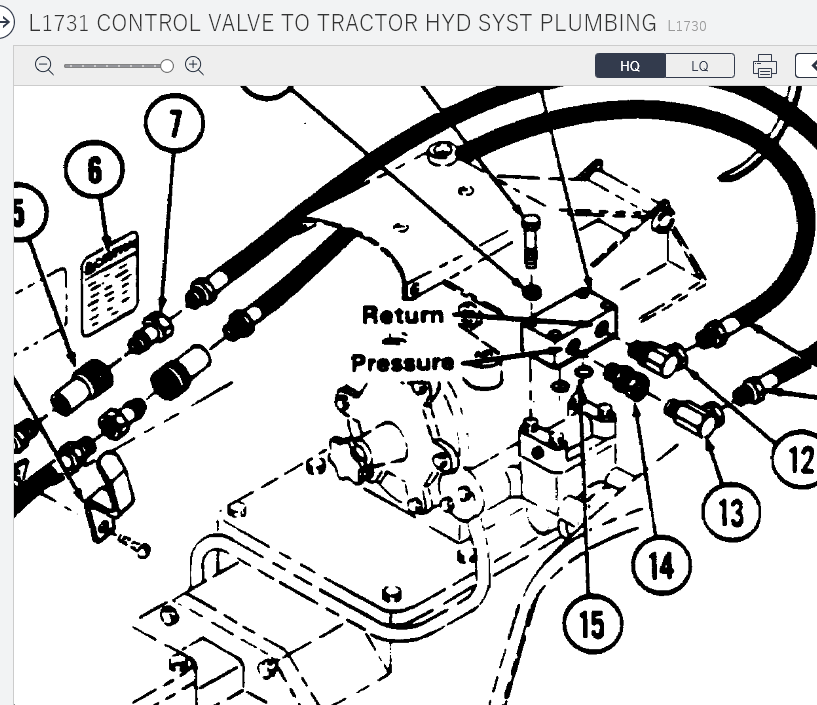

First thing you need to do is verify that plumbing.. Number 4 should go to front port on hydraulic outlet and number 2 on valve to the rear port. Diagram below is for the L1730 loader but it shows the port assignments on the L245 hydraulic outlet block.

I am thinking the four going out to the cylinders may be mixed up. Each set in line with a control handle, should go to a set of cylinders. Looking at your picture, the inner two should go to the boom cyls and the other two to the bucket cyls.
chriscraw
L245DT
Jun 11, 2022
Central VT
You're absolutely correct! I feel like an idiot. My paint marker writing was so bad that the D looked like an A, and I had them in backwards. It's working great now.
