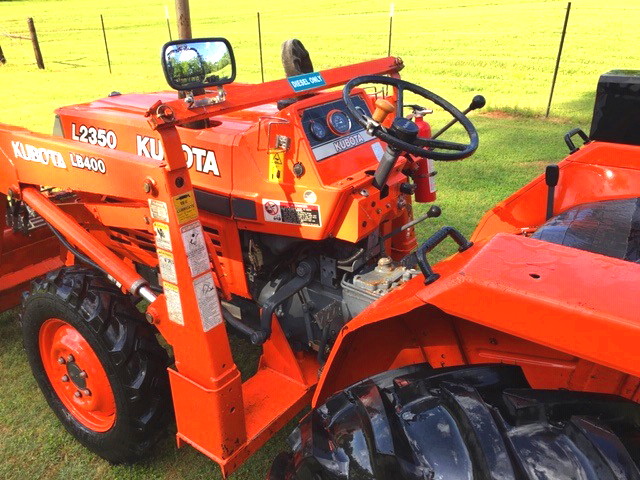

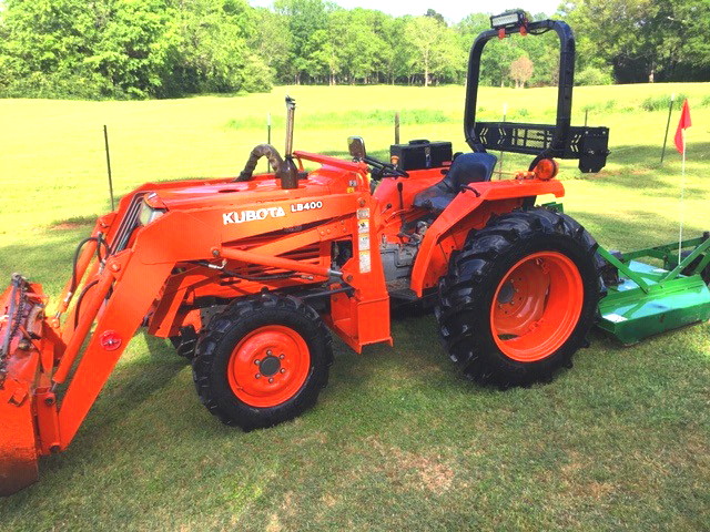

28 yr old 'L' Series.
NOT lesser quality. Just a smaller framed tractor.
Personally, I wouldn't have a tractor that had a FEL that wasn't 4wd. There may be some applications (light duty moving of material and general lifting) where 2 WD is suitable. But for digging, pushing.... the advantage of 4 WD can not be overstated.
