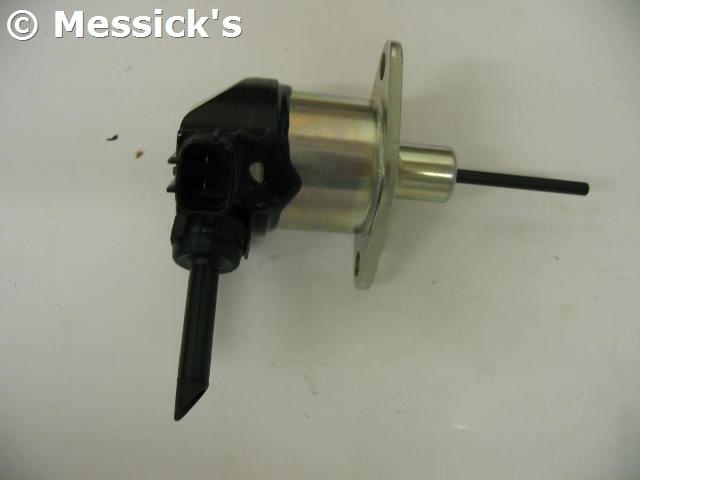

Here is the solenoid and where it is located.

If you suspect the solenoid, (which is an unlikely failure), remove it briefly. Remember then you cannot stop the engine with the key!
I think you will be more productive on checking out the fuel filter for water and ice.
When did you buy the diesel fuel you are currently using?
The only free WSM for an L3400 is from Scotland and may not represent the safety controls your tractor has concerning the stop solenoid.
From looking at other tractor models the same part fits, I believe the stop solenoid on your engine has two internal coils. a Pull in coil to actually move the plunger and a hold coil to keep it retracted once moved by the pull in coil.

As stated before. Your fuel solenoid is the least likely culprit. If you hear a "click" at the solenoid, chances are that it is working.
Gelled fuel is more likely.

Thanks Dave but the solenoid does not click which is why I suspect it is the problem. I was thinking it may be stuck by being iced from the rain and ice storm we just had. I also saw the parts diagram online but still can't locate it. I will try again soon.

I think on that model the solenoid only engages for a short period of time when you shut the tractor off?
