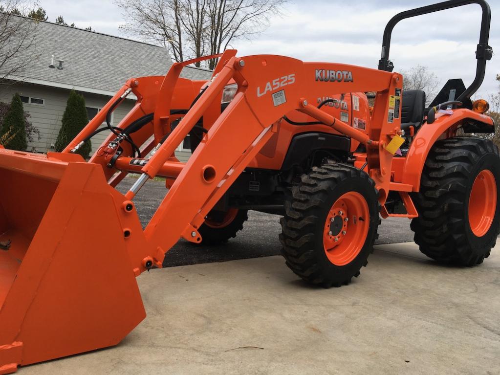

My new L2501 was delivered today and thought some might be interested in my build as I modify the hydro and clutch for hand control use.

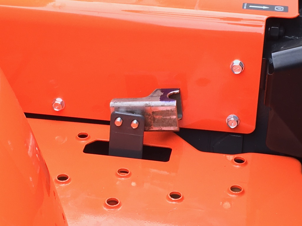

This first set of pictures is the as-new tractor in my driveway and also of the first bracket for the hydrostatic lever.
This bracket will be bolted on and is cut from a piece of 1 1/2 square tubing. The bracket is designed to weld a 3/4 inch heavy wall seamless tube that will make up the lever. I was able to utilize the existing bolt holes/bosses and will reinstall the treadle pedal in its original location. This lever will come up between my legs and allow for full forward and reverse movement. This will allow hand or foot operation.
