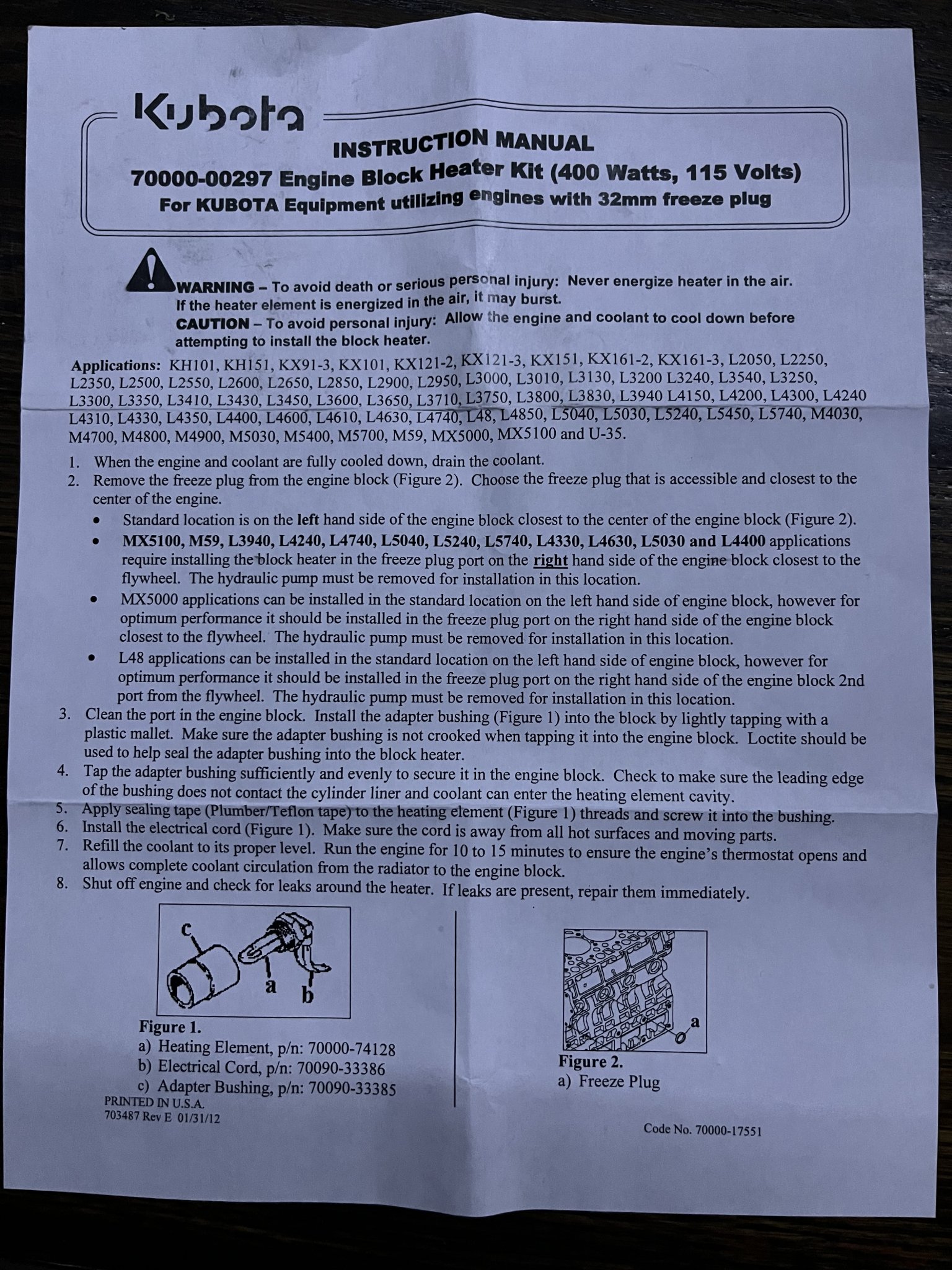

Ok finally got it figured out. The correct Kubota block heater for the L2350 is part# 70000-00297 and the assembly comes with the sleeve to drive into freeze plug hole and thread heater into. It fits a bunch of different tractors and most everything with the D1102 motor looks like. Found a mechanic at one Kubota dealer that remembered the mid 90’s and said they installed them in place of the left front freeze plug. Knocked left front plug out drove in the sleeve threaded it in and works like a champ. I keep my diesel pickup block heater on a timer to turn on a couple hours before I leave for work but like others have said this only needs 15-30 minutes and fired right up at around 30 Fahrenheit.

Thanks for posting this information and installation pics. I have the same tractor and have contemplated doing the same. Now I know what to order and how to do it. (y)

Very nice install.
I had to chuckle at the instructions regarding leaks however.

Very nice install.
LOL, always have to check for leaks but you know how it is if it didn't specifically say you should fix leaks it would be the tractors fault you cooked it.
Few hours plowing snow so far no leaks all fluids are at operating level and fires up happily after plugging in for 15 minutes!
