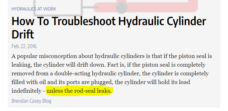

So your saying that an internal seal leak can not cause a cylinder to loose lift pressure?
I am not sure how to answer that. Lets try this:
A piston seal leak can/will reduce the effective working area of the cylinder. It will become the cross sectional area of the rod and that will result in a loss of lifting force. If the leak is slow and the cylinder lifts normally the cylinder pressure will climb as the cylinder holds and the pressures equalize across the leaking seal. This is the point at which a port relief comes into play.
32,876
8,355
If any of the internal seals leaks then the fluid from one side of a cylinder will move to the other side of a cylinder making the lift force drop, thus the cylinder drifts off.
So if you lift the Excavator with the blade and the excavator drops back down, it most certainly can have a blow internal seal.
Yes it could also have a leaking spool valve, but that is much less likely, especially with a newer unit.
9,307
4,844
The rod CANNOT drift inwards. That would reduce the volume of oil in the cylinder and there is no place for that excess oil to go. So forget oil moving from one side to the other - can't happen.
The rod stays locked in place and the oil pressure on the base end builds to reflect the loss in effective piston working area. The base and rod end pressures ultimately equalizes at an increased level which is now working over a smaller area and equal to the force the cylinder is holding. Read the entirety of the article I linked.

I have the same issue with my old excavator. I understand what Dan is saying. Think about it.
If you have a hydraulic cylinder and fully extend it by pushing oil in the cylinder, and then cap the two ports on the cylinder, and if the seal at the cylinder rod functions normally, so no oil leaks out, then if the cylinder rod went into the cylinder, the volume inside the cylinder would decrease.
So where would that oil go? Nowhere, since it cannot leak out of the cylinder. So the cylinder rod will never enter the cylinder unless there is someplace for the oil inside the cylinder to go.
So unless there is a leakage path outside the cylinder when the cylinder for the blade is fully extended, the blade will not move.
