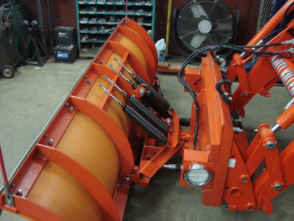

Looking for the trip springs for the blade, the ones that allow the blade to lay down when it gets caught on something.

Just a dumb question,,,,are you sure the blade lock is disengaged?

Do your cutting edge trip or the full blade? On mine, the full blade would trip then it woud recoil back so fast it would throw snow at the cab. To prevent this from happening again I installed a double acting shock so when it recoils the blade comes back slow.
Lock is disengaged, can get it to move a small amount but still will not lay down like it should. Guess I will have to see if it will loosen up after use. Have to get some snow first I guess!
It is the full blade. I only have one spring on mine. Will see what happens when we get some snow.
