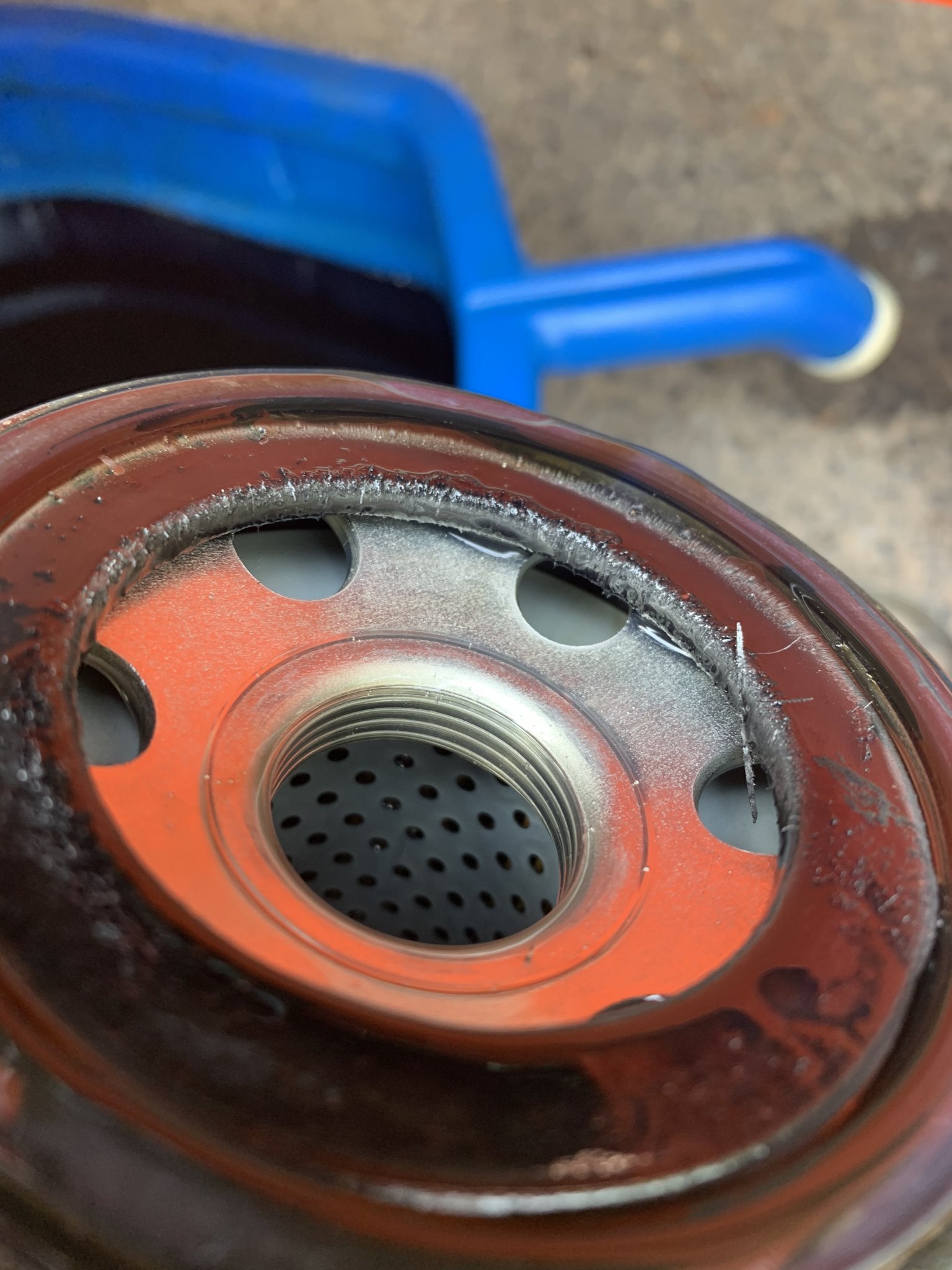

This was my filter at 125 hrs. The previous owner never did the 50 hr. This is the right side filter, if sitting on machine. Do it fast and you shouldn’t loose much.

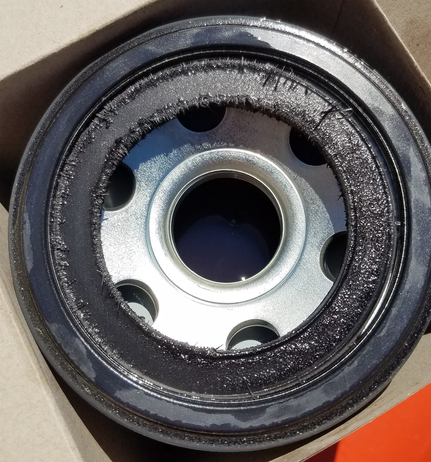

I have 49.6 hours on the MX so changed the oil and three filters this morning without any issues at all. All three filters came off easily but I was surprised by the amount of metal shavings that were stuck to the magnet on the hydraulic filter (see below). I lost the hydraulic oil in the filters and maybe a quart or two more into a bucket when I removed the hydraulic filter on the right side, but had an unopened quart of UDT2 oil that I'd bought for the BX so added that back into the system. After running the hydraulics and checking the sight glass the level looks good but I'll check it again after cutting a friend's field later today.

Congrats on the 50 hour. My magnet actually had a little more shavings than yours. Guess that's what its there for. Did you have any non-magnetic silver colored stuff come out of the left side filter?
6,590
8,774
Not that I noticed. I thought that the cast oil pan was cracked but I'm hoping it's just flashing and need to get under the tractor with a light.
