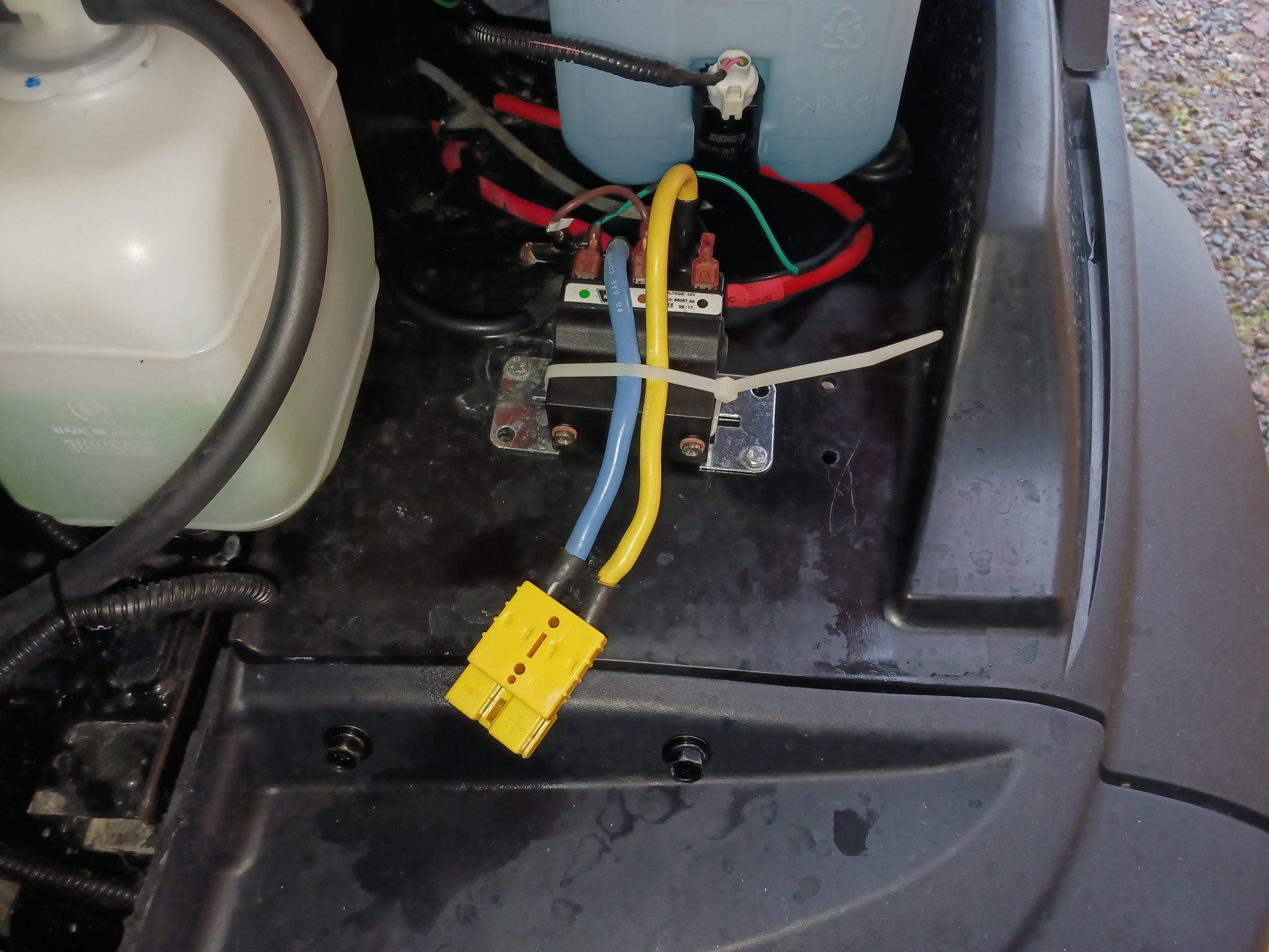

Sounds like you need to mount it in the REAR of the machine. Assuming 12 volt winch, consider Anderson powerpole connectors, 2nd battery and 'battery isolator' setup.

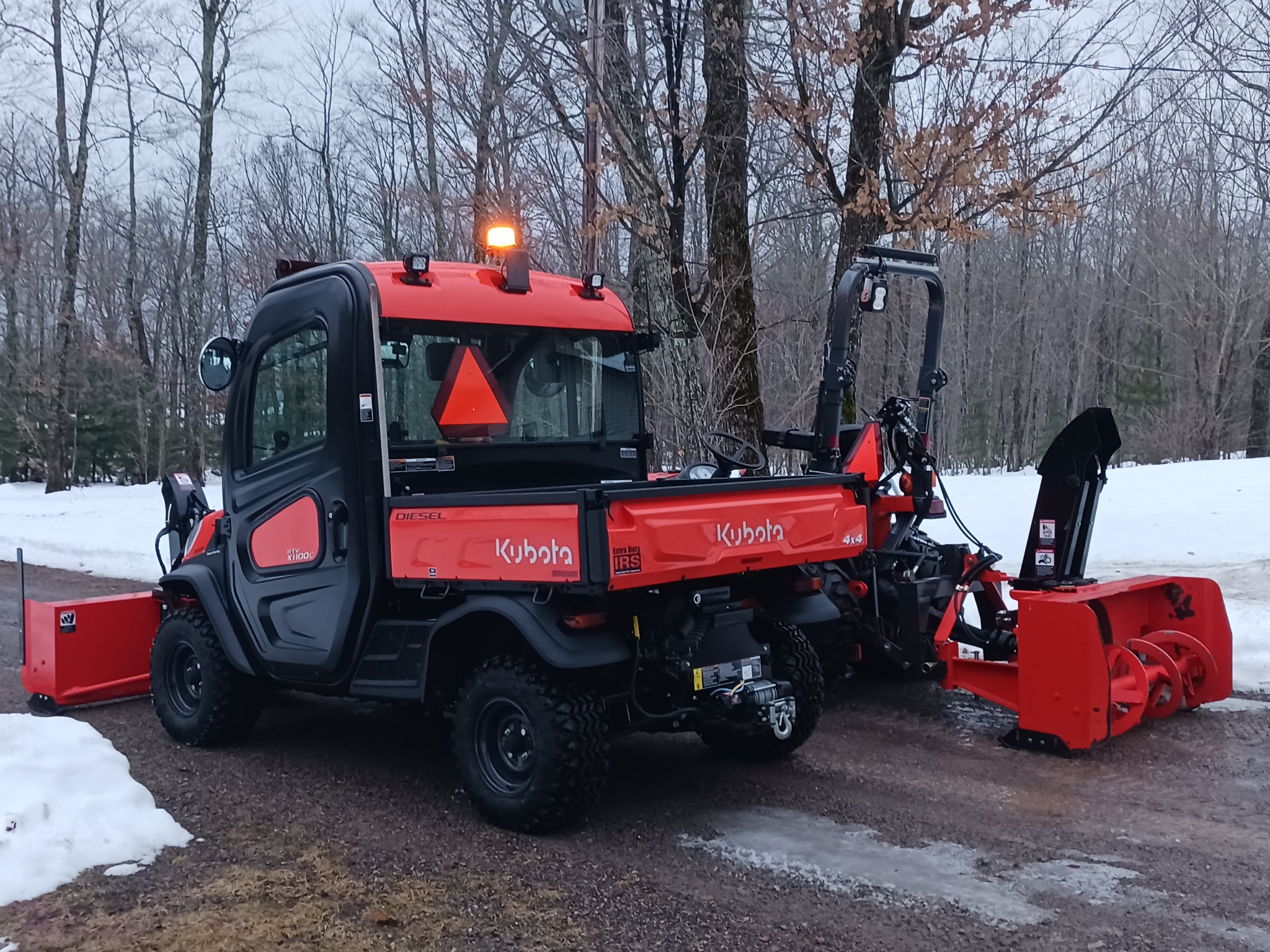

That's what I have, a receiver hitch mount and front and rear wiring all from Orange Aftermarket.
So I've always had it mounted on the rear ever since I had the Boss plow, now the K-Connect blower installed.
ItBmine
B2620, RTV-X1100C
Jan 21, 2014
1,457
473
No extension. Everything fits. I think the extension was only so you didn't have to reach under to put pin in? Because I did have the winch in the front before I put the plow and blower on it.
I would have need an extension to use it with the Boss plow harness on though.
I am not sure how everything work with the blower now though. They did give me a kit to put the front receiver and grill guard back on if you remove the power pack but I haven't really looked at it yet.
My winch is a Warn XR45 4500 pound. And it has a plug in remote control.
