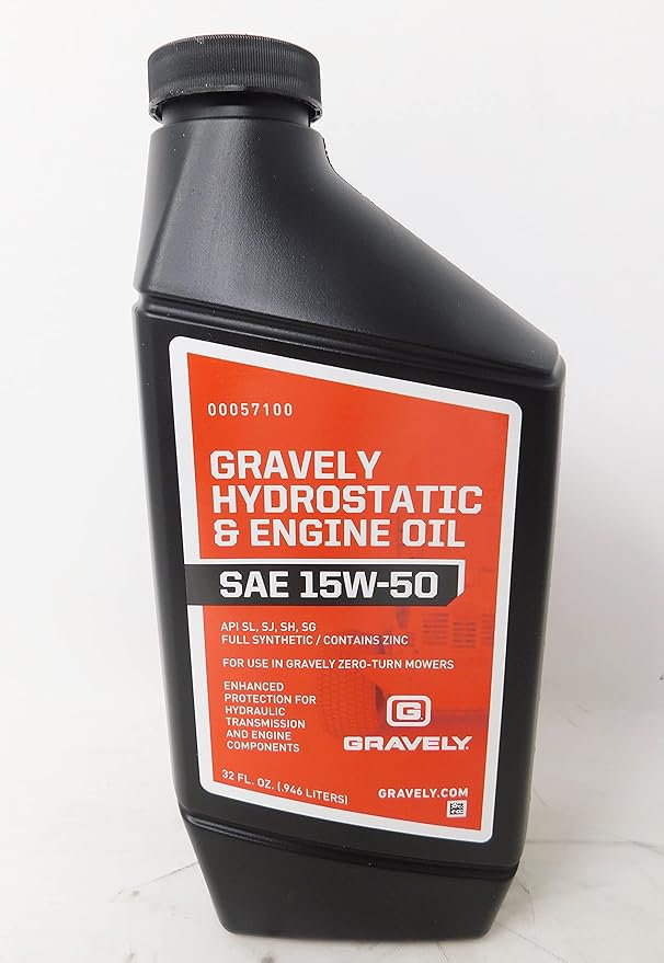

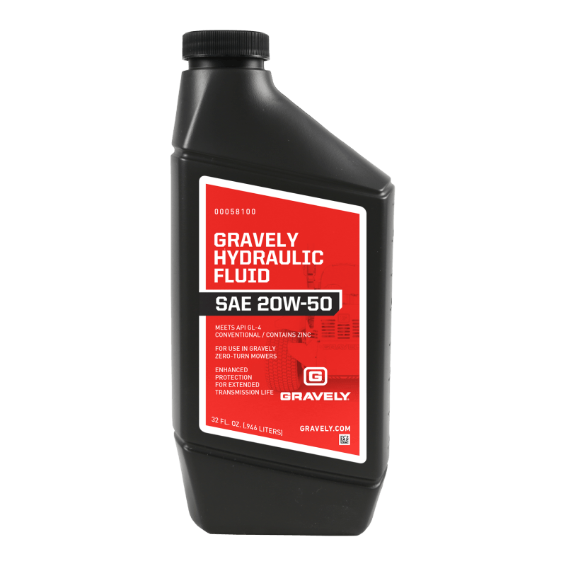

I did check the manual, it's recommending 15W-50 hydralic oil. With a viscosity rating like that, it looks more like an engine oil and with done digging, I found two different fluids. I suspect they're using engine oil for both.
9,869
5,233
The label clearly says 15W50 transmission and engine oil. HydroGear switched to engine oil in their transaxles some time ago.
