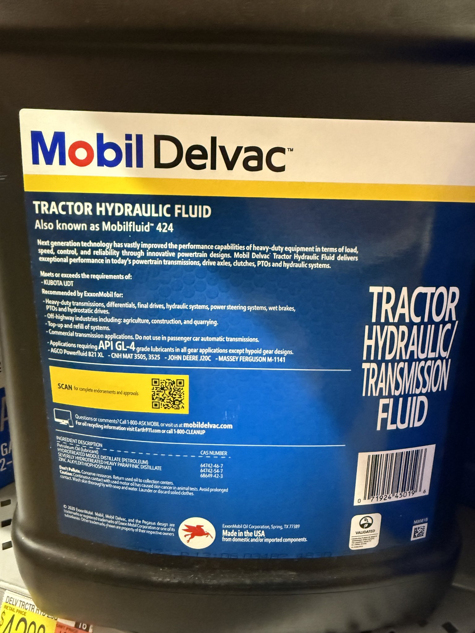

According to Mobil:
"MEETS OR EXCEEDS THE REQUIREMENTS OF KUBOTA UDT"
Saw that, first tractor and first time buying hydraulic fluid. Found it on the shelf at Walmart after Napa could not locate any until next Tuesday and that was gonna be 175$ so when I saw this for 42$ I thought I’d ask Here first.

What size container is that Mobil One oil for $50?
A 5 gallon pail of Mobil Delvac THF (aka Mobil Fluid 424) is $75-$85 at farm supply stores. It has been around a very long time and is one of the products the B9600 HST Owners Manual listed by name (Mobil Fluid 423 at that time) as an equivalent for UDT.
Super UDT2 is a different formulation with improved properties and more demanding requirements. That specification was developed in the early 90's.
SUDT2 is a lower viscosity synthetic lubricant offering better performance much like synthetic engine oils perform better than conventional mineral oils. It is the Kubota equivalent to John Deere Hygard Low Viscosity (J20D) and CNH Akcella Hytran Ultraction SSL (MAT 3451). Mobil does not claim their product meets any of those specifications.
Today Kubota recommends the use of SUDT2 in all of their tractors but still lists UDT as an acceptable alternative.
The SUDT2 versus UDT (and by extension third party UTFs) debate is much like the synthetic versus conventional engine oil debate. As a class one is a little better than the other but as long as you change the oil on a suitable interval your tractor will be happy on either.
Personally I use SUDT2 and Rotella T6 5W40 in my pretty new L3901 HST but for decades the old B7200 has seen nothing but $8/gal Traveller Premium UTF and whatever 10W30 diesel engine oil was on sale.
