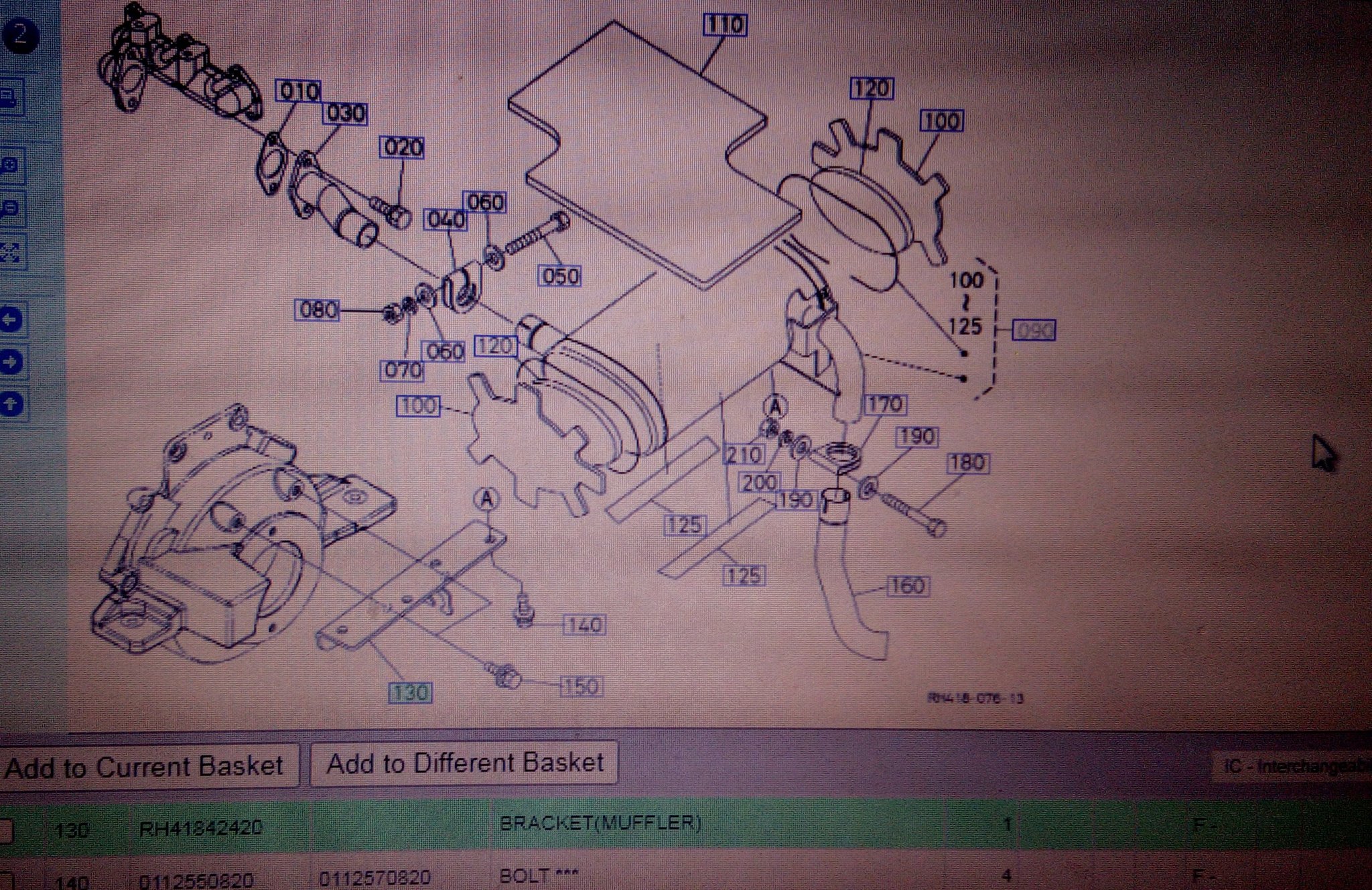

TECH101 Member Equipment Kubota - Bobcat - Caterpillar - Case - John Deere - FARM - CONSTRUCTION - Mar 8, 2022 30 6 8 Canada Jul 1, 2023 #3 I would check 130 (green) on drawing they like to come loose causing a rattle
