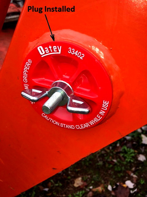

Apparently Kubota uses several different size tubing on various tractors.

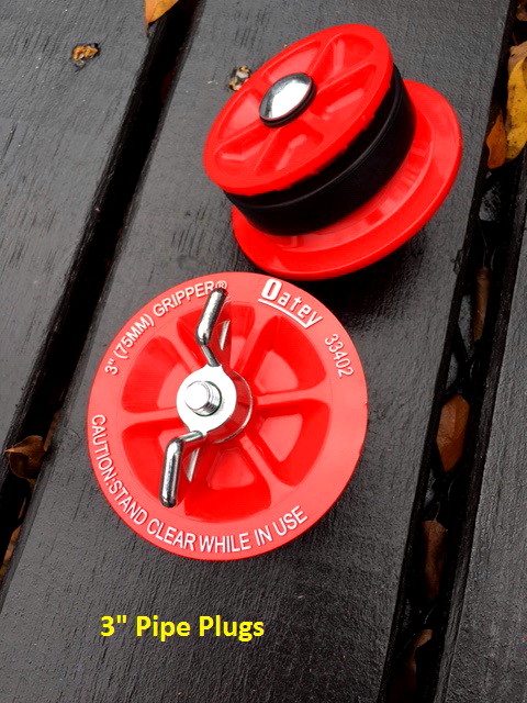

My L48 TLB has a 4-1/2" tube, which requires some method of reducing the interior of the tube ends for a 4" Oatey plug.
The only thing to "figure out", is if there is an Oatey plug that will fit, or can be adapted, to your particular machine tubing size.
Use another short piece of the tube, cut to depth inset of the plug. Slice crossways to remove a section, to allow squeezing the short piece to slide inside the main tube. Once fit, glue in place with the appropriate glue, done. Insert plug.
8,005
5,187
A squeezed piece will not be exactly round, but will be round enough for the Oatey plug to grip.
In my case, the 4" PVC (with 4-1/2" outside diameter) was a perfect fit for the Kubota 4-1/2" I.D. steel tube.
For me: nice press fit....no glue required.

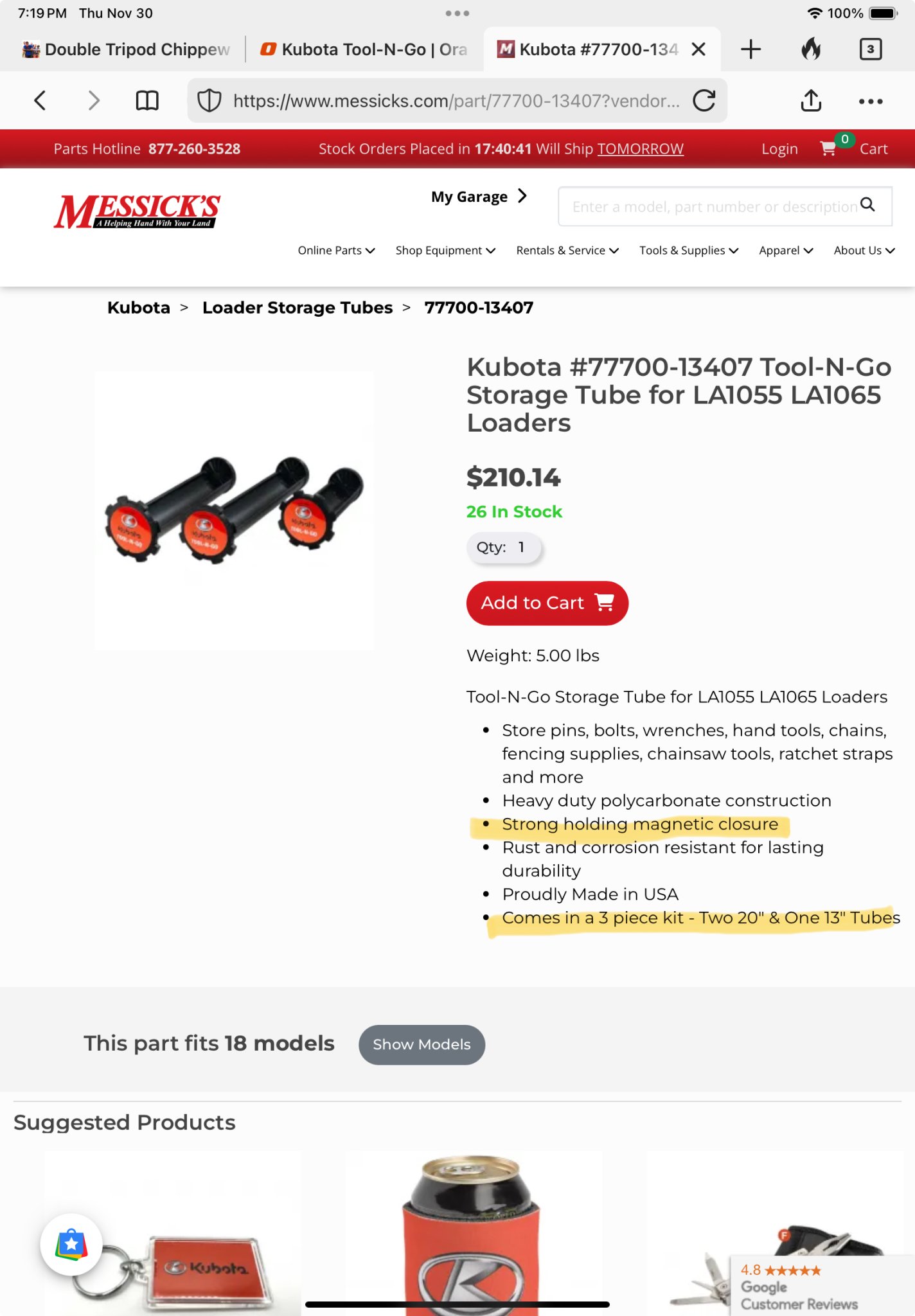

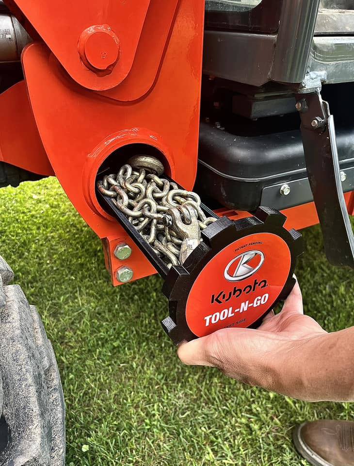

Seems like a bad idea to have a 3/8chain in one of these then trailer your tractor. Im sure the tiny neo magnets can hold it driving around. Bouncing down the highway with 20lbs of weight is a different story. Should have designed it to grab the inner edge of the tube. Some tubes are cut very rough. There will be varied magnetic strength on those machines.
Magnets can lose strength by being impacted. So sliding them in may affect that strength.
The horizontal forces won't be that much. My guess is that strong magnets would be fine.
But, the price is a lot to overcome. :D

The price is a lot to overcome. :D
Which is a strong point behind my making/modding most things, if I can do as good or better in design for less. 👍

You can get fitting plugs instead of pipe plugs, which will fit the OD of the pipe/ID of a fitting.
I bought a couple of the ones in the OP, they were delivered yesterday. I will make my own with some PVC pipe and plugs for the FEL cross tube though.
8,005
5,187
The plugs that I referred to are NOT "PIPE PLUGS".
The "Oatey" (brand) plugs that I refrenced are plumber pressure test plugs.
A very different animal from a "pipe plug"!

I never thought about that being a good place to store a chain but being cheap like I am I'm going to see if a bungee cord stretched on each end will hold my chain.

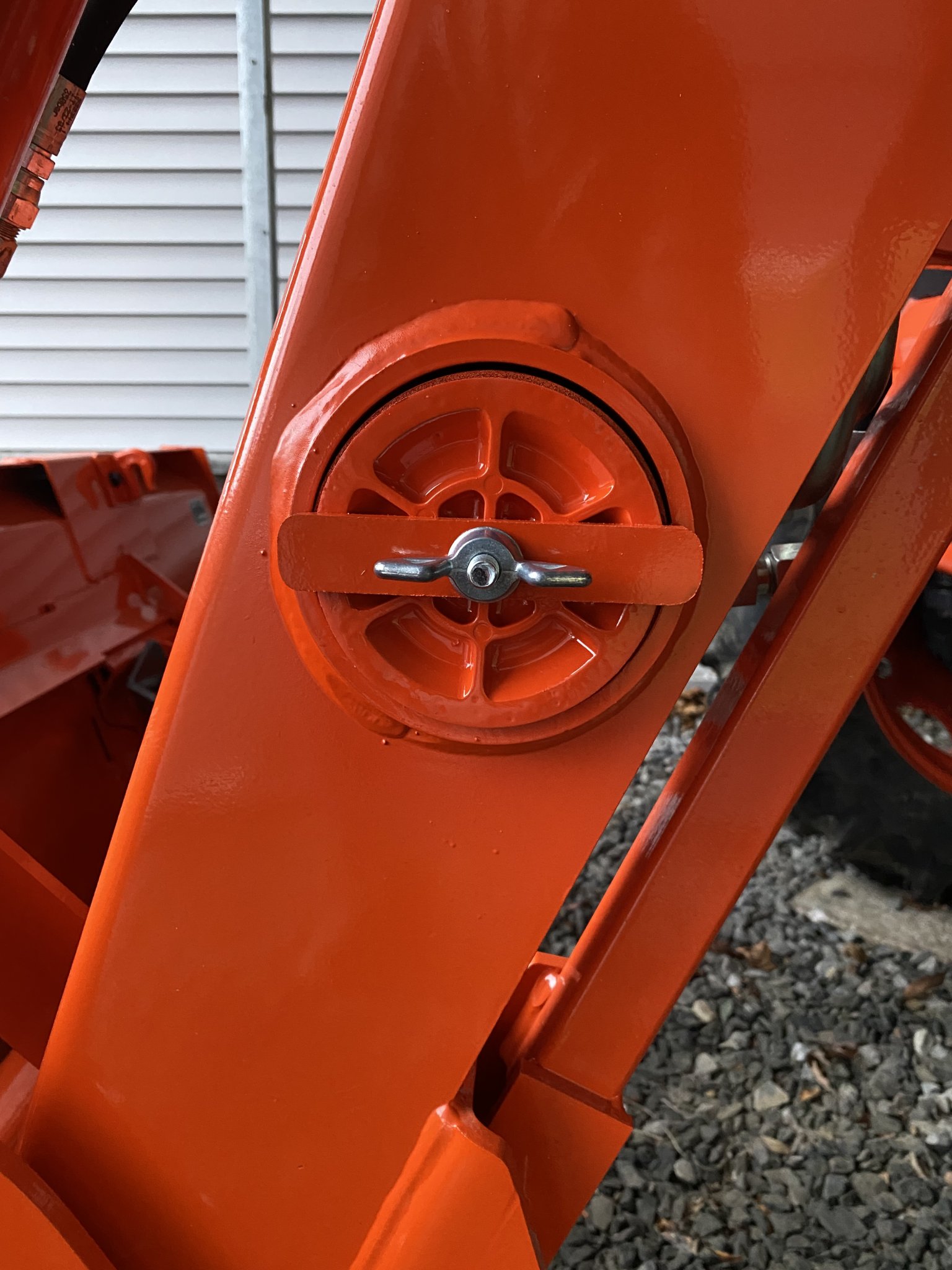

This is what I used in the FEL tube for chain storage on my M6060 with an LA1154 loader. The inside tube size was a little inconsistent due to weld inside the tube. I found that a 4” piece of S&D pipe would fit tight if you used the bell on the end of the pipe. I centered the bell in the tube and used self adhesive thin weatherstripping on each end of the tube along with 4” expandable plugs on each end along with a small plate just in case the tube would slide (drove pipe in with hammer and block, don’t see it moving) Also used a little orange paint to make it look like it should be there. IMG_1983.jpeg IMG_1984.jpeg IMG_1986.jpeg

I really like that "stopper plate" idea.
Good thinking!!! (y) (y)
