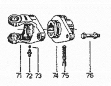

I understand from your posts the following:
The tractor PTO seems to work correctly. It spins with nothing attached and does actually drive the tiller input shaft. Is that correct?
The PTO shaft on my different brand tiller has a strange shear pin arrangement. The yoke at the tiller end has a tab that has the shear bolt through both tabs. The yoke is split and has a simple ball bearing arrangement in case the shear bolt fails, the tractor end would be able to rotate while the tiller side would be static. If the ball bearing was rusty it would make some noise.
Does the input shaft into the gearbox rotate by hand? If so do the tines rotate (if tiller is off the ground)?
You may be able to easily remove the gearbox and see if it rotates easily
