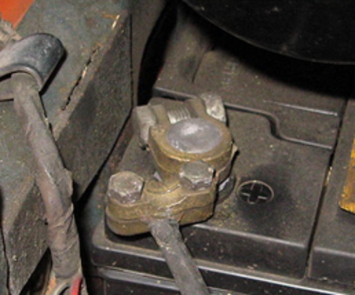

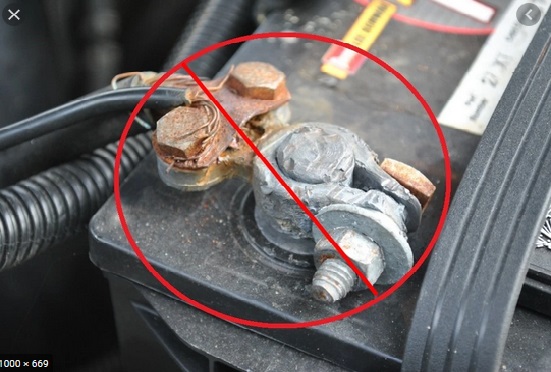

Please post photo of the top of your battery.
I am looking for replacement cable ends.
If you have anything that looks like one of the above, invest in a complete new cable.
These ends also render boosting or help from a battery charger useless.

I think I have at least 1 of what you're referring to. what type of ends do you recommend?

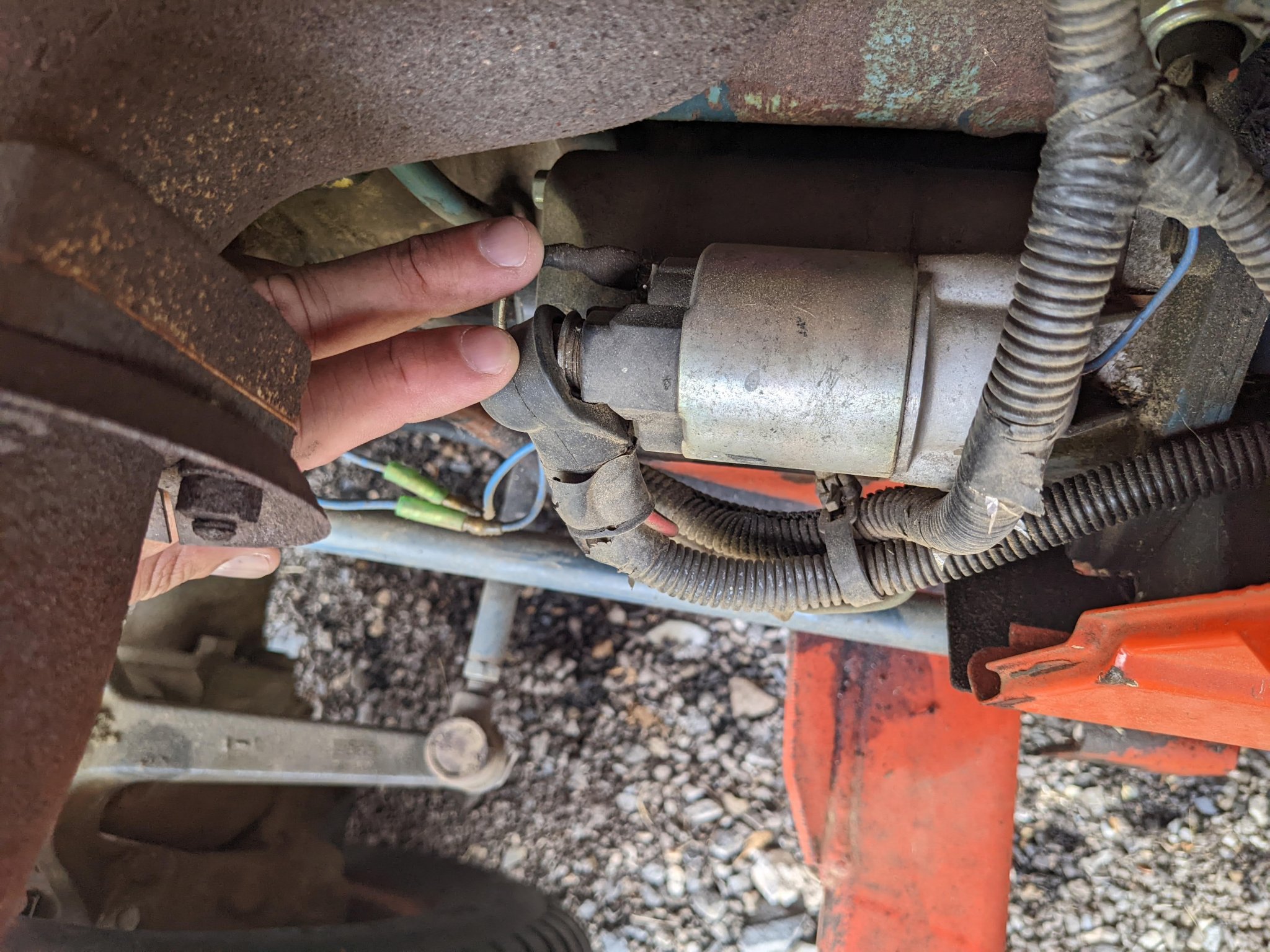

Here's what I have for voltage measurements... let me know if I did something wrong or if you want other data.
Battery terminal neg to pos - 12.91
Battery terminal neg to front of starter (bottom location in pic) - 12.91
Battery terminal pos to front of starter (top location in pic) - 12.91
Battery terminal pos to tractor frame - 12.92
I'm a big fan of military battery terminals, available at various vendors, both online and brick & mortar. Some people like marine terminals, which are also good. Top clearance for these can be an issue in some applications.
If you need cables, check out BestBoatWire.com Made to your order; cables, connectors, heat shrink. I like to get the clear heat shrink so I can see what's going on under there. I've had quite a few cables made by them, and the quality, price, and service have been very good.
All of those measurements are EXPECTED when machine is sitting and no current is passing thru wires.
Two basic voltage-drop measurements:
  1. Master Ground wire
    1. Neg meter lead on BATTERY MINUS post (not on the connector!!!)
    2. Pos meter lead on ENGINE CASTING
    3. Measure voltage WHILE CRANKING ENGINE
    4. expect less than 0.050 volts (50mV)
  2. Master power to starter
    1. Neg meter lead on BATTERY POSTIVE post (not on connector!!)
    2. Pos meter lead on LARGE wire on starter bendix
After you have checked the above two measurements, the results will lead us to the next step.
Anything more than 0.050v should be considered a problem.

It seems the edit to my one post didn't save, so I'll post here so I know people see it.
In the post with the voltage readings, I incorrectly stated "starter" when it was actually the "solenoid".
Also, I tested the terminal connection with the key in the 'on' position.
The reading for the neg to pos terminal went from approx 13 to around 2.3 volts
then I connected jumpers to my truck and it was back up to just over 13 volts
with the jumpers still on, the reading from neg terminal to solenoid was at the 2.3 volt reading, but the pos terminal to the solenoid was still around 13 volts
Am i doing these readings correctly or should I check voltage somewhere else?

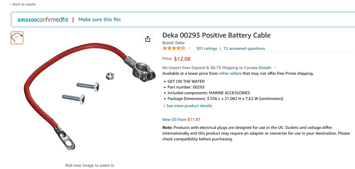

Here is an Amazon example of what I am recommending you get.
Any automotive parts place will have them in different lengths.
I would suggest you also replace the negative cable.
One caveat to beware of.... A LOT of the electrical stuff available on 'Amazon' use ALUMINUM wire...or even worse, STEEL wire. (sometimes coated with thin layer of copper-cladding to make it appear like copper)
Be aware that anything less than copper will not conduct electrons as well. (will have higher voltage-drop across wire) Your starter will not spin as fast.
