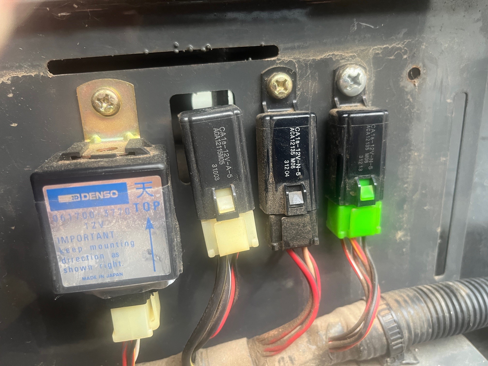

Ok - I just got this thing back from my brother-in-law who said he could fix it and got nowhere with it, so I am going to start over looking at it myself this week when i get time......does anyone know what the relays in the attached picture do? I cannot seem to locate a wiring diagram for it.

How do I know which one my unit has? Fuel on or Fuel off?
The RTV900 uses the shut-off that is only energized for a few seconds after you turn off the key switch.
A simple test for this style is to unplug the shut-off solenoid which is mounted above the injection pump. If it starts and dies with the white wire unplugged, your problem is not electrical. If it starts and stays running, it's electrical.
When you bleed the fuel injector lines, do not loosen them on the injection pump, loosen them at the injector on the cylinder head.
