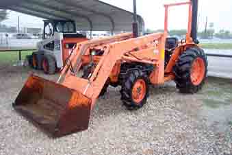

GKTILTON, any chance you can share a photo of ROPS installed? I also have a B7100 (approx 1980) got the ROPS thru the program from dealer. It is the newer light bulb style.
My issue is that I have a Sims cap installed. I do not think the ROPS is going to fit with the cap. May need to rework how the cap installs so that I can have the rops on my rig.
Would like to see photos from side and rear to see where the ROPS lands near fenders etc. The unit I received does not fold...

This is the only picture I have here at work. If you want something from a specific angle I will happily take some tonight. It makes my wife laugh when I take pictures of the tractor, since I never take pictures of the kids. :)
Edit: I didn't see your full question, Rear angle and Fender clearance pictures will be here tonight.
