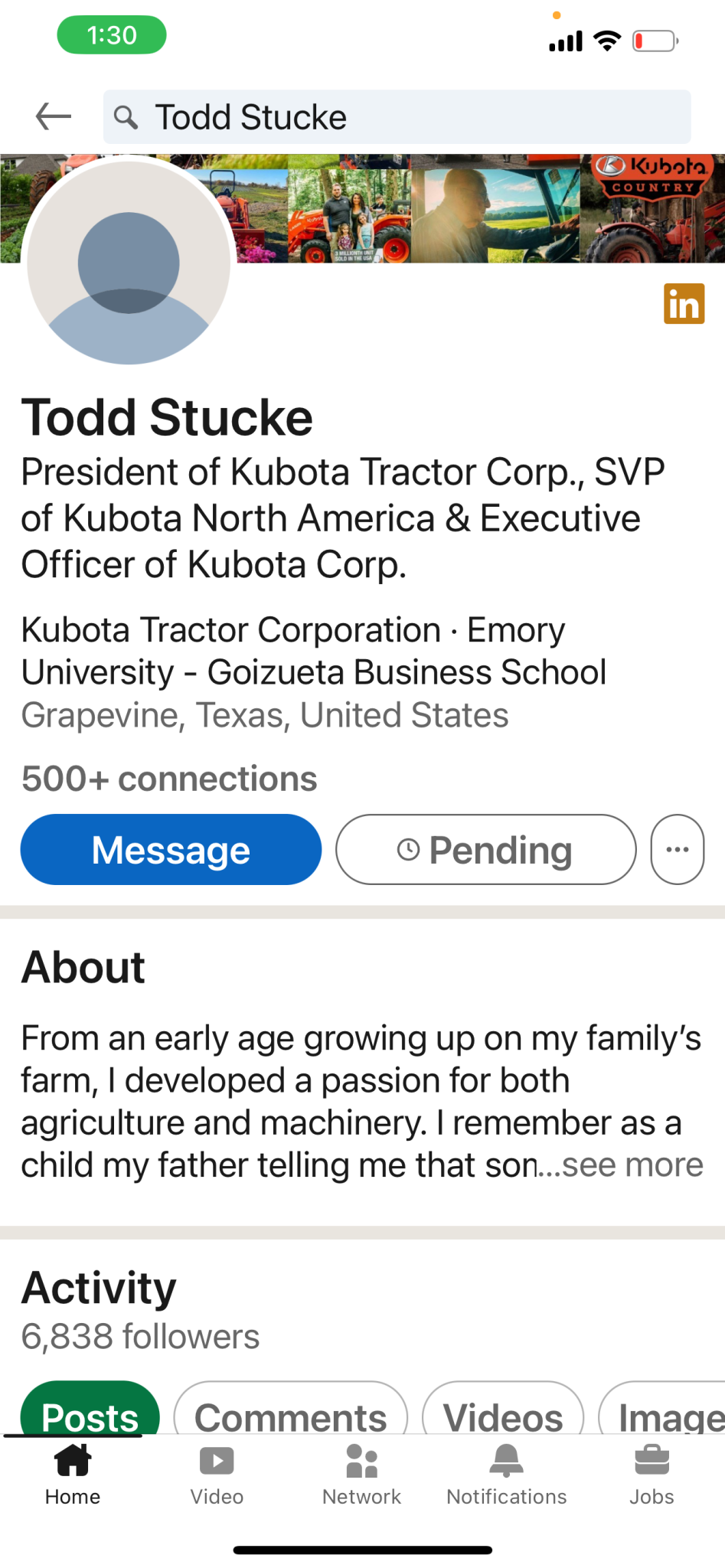

I couldn’t sleep this weekend thinking about it. I decided to reach out to everyone I could find on Kubota including Todd Stucke, President on his indeed.
Let’s hope someone sees it!
