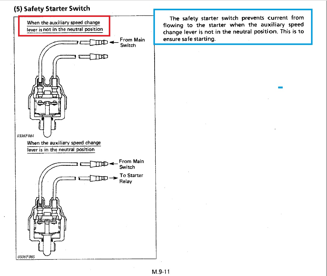

The starter safety switch is the only safety switch which affects the starter from engaging. It should be easy to find and check with a test light or multi meter.
When you say you have 13 volts everywhere, this is meaningless unless you are checking the voltage at the starter when the key switch is turned to start. i.e. when the electrical system has a heavy load.
When the key switch is turned to start not only does this activate the start relay but also the glow plug relay to keep the glow plugs hot when the engine is cranking. The click you hear could be the glow relay and not the start relay because the safety switch is not satisfied.

Thanks Tried to jump the starter and it would not jump went through the harness and found the safety switch was unhooked and the wires haphazardly tied together. Tested the switch hooked the wires back up and running great thanks for the help
