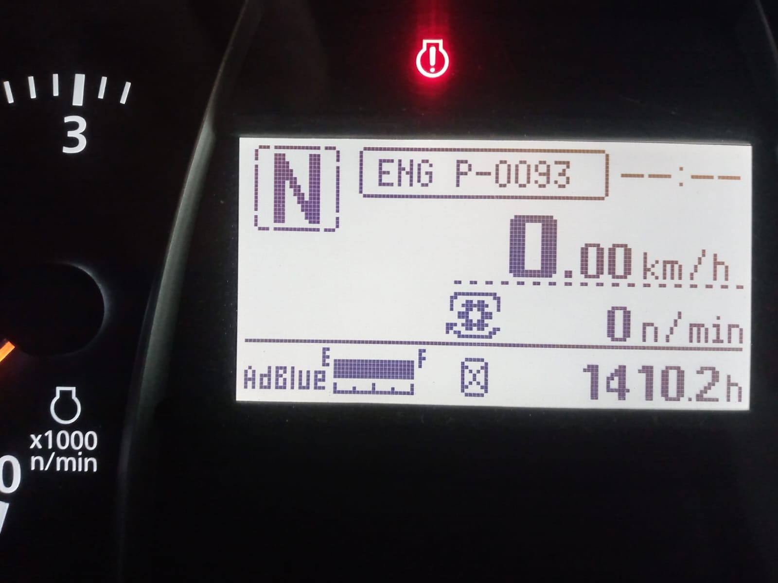

Hello, I'm back with a new problem, recently the tractor started showing me this error code. From what I've read, it has to do with fuel pressure.
When the code appeared, the engine wanted to stop but did not stop and came back again.
The next day it appeared for a few minutes and then worked fine all day.
The diesel filter was changed by the previous owner recently. But not with an original one, but a hifi filter.
Could there be dirt in the elbow of the decanter filter?
Or is there dirt in the filter of the electric diesel pump?
I haven't checked them yet.
The tractor has 1400 hours.
What could it be?
I don't think it's an injector, or the high pressure pipe or the pump.
What do you think it could be?

The most common cause is a restriction in the fuel supply to the mechanical high-pressure pump.
Remove the fuel hose from the outlet side of the electric fuel lift pump, insert a short section of loose hose, and hang it over a bucket. Turn the key switch to the ON position but do not crank the engine over to see how much fuel flow you are getting to the spin-on fuel filter.
If you have a weak fuel flow, remove the water separator, disassemble it, and blow through the port below the shut-off lever with compressed air. You may very well have debris plugging the 90-degree inlet elbow.
If you have a good flow, replace the spin-on filter with the correct one as most of the will-fit filters are 15 microns or more. The correct filter is 3 to 5 microns.

I think I discovered the problem, the electric fuel pump has a very low flow, and it lets the fuel go back.
I will buy a new electric pump and come back with updates.

I'll be back with updates, before I installed the new fuel pump my decanter filter was half empty, now with the new fuel pump it's always full, I haven't used the tractor much yet, but I hope everything is resolved.

And I discovered another problem today, I was moving the decanter filter valve, and I could see that sometimes more or less diesel was coming in the open position.
I said to open the tap, everything was fine, but when I took the filter support down, I see the hose coming from the tank with a rather large hole.
But it was pulling more air than losing diesel.
And the diesel that was flowing could not be seen because it was going down on the protection of the hose.
I hope everything will be fine from now on.

But the new pump also makes a difference, because the old pump had a worn internal piston, and the valve in it stopped closing, losing a lot of pressure.
I hope everything is fixed now
