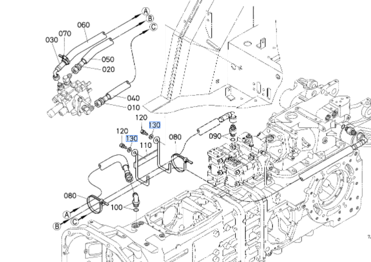

The hydraulic circuit is pump to loader valve to remotes to 3pt.. The loader is supplied by a hydraulic outlet on the front of the transmission as shown in this parts diagram:
Hose A (030) is the pump supply from tractor to valve
Hose B (020) is the low pressure tank return from the valve
Hose C (010) is the high pressure carryover line for the remotes and 3pt.
Assuming draft control is not active and you have verified that all control valves are in neutral a pressure check would be in order. Ideally you would remove hose A from the valve and connect a pressure gauge to the hose to see if you are getting pump pressure. If that checks out then something down line is blocking the circuit. Getting to that test point may be less than straight forward if you have a cab.

Go back up the thread to the parts diagram I posted. It looks like hose "B" is pump pressure into the loader. Disconnect that hose and hook a gauge to it. Start the tractor and you will read pump pressure. You will be running the pump against the system relief so don't run it like that for more than a couple minutes. If its low you still don't know if its the pump or system relief.
