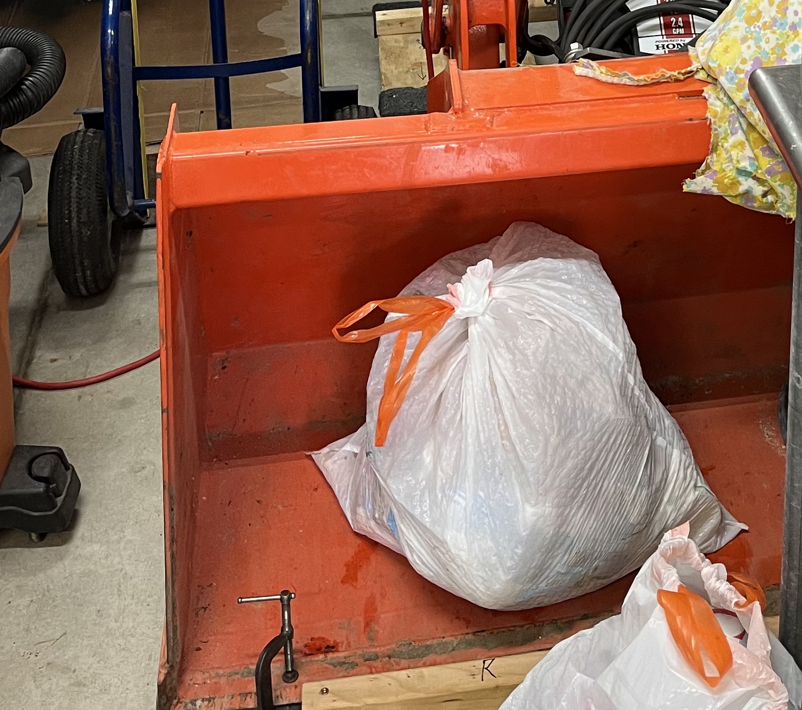

Hello everyone, every winter I remove my loader and install my front snowblower. I use 4 dollies that are attached in pairs with 2x2’s. I jack up my loader with floor jacks and two 3.5x3.5” blocks between the stand mount and the boom towards the front and use a pair of dolly’s under the bucket and a pair under the stands. The bucket has the 2x2 up against the cutting edge and I C-clamp the dolly, one on each end. The stand have a bolt through the hole in the bottom through plywood on the dolly. I use them because my goldfish bowl is full and the goldfish is the size of the bowl! Then I can roll it and store it for the winter.
