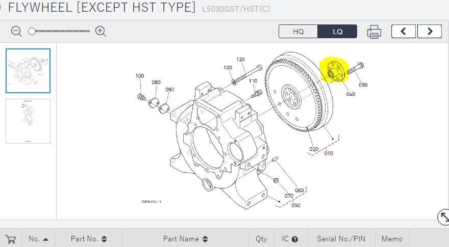

Yep mechanical clutch is fried, sounds like the pressure plate has gone south.
And the reason the PTO still works is it's direct driven off the crank via a hub that does not rely on the clutch.
