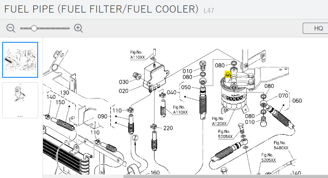

Loosen this purge plug and turn the key on do you get pulsed fuel flow out of it?

Thanks for the recommendation. I will try that next. I do loosen that a few turns to purge the air but didn't think to see if diesel flows through it. I'll let you know!
Ok so I took this plug out and turned the key and a lot of fuel was spilling out. I'm thinking it is not the fuel system. Is it possible its something related to electrical system? I do remember hearing a loud click right before it stalled the first time. I checked all fuses and they are all good.
