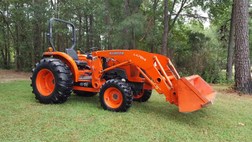

I have a 2012 L4600 DT I purchased back in the summer that had 178 hours on it with FEL but no shade.
I live in eastern NC, asking price was 22K and we settled for 18,500 cash. Couple of days cleaning and it turned out like new.
It does smoke when cranking but after that she (her name is Katie) runs like a top.
I changed the oil, added fuel additive, changed air filter, made floor mat, waxed, added tool box, hooks to the bucket, and chain holder to bucket.
No problems so far, love it.
