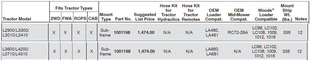

I am in the same situation. I am wondering if a LA481 from an L3010 will fit on an L3710.
My situation is that my L3010 was totaled by fire during transport via a commercial carrier when I moved. The fire destroyed the back end of the tractor. The engine and loader appear to be unaffected. The backhoe is also fine. I found a reasonably priced L3710 nearby for a fair price. I know the backhoe subframe part number is the same between the two. Woods loader spec sheets indicate that all the Woods loaders are interchangable. I can find any info on the Kubota loaders. I would like to move the loader from the 3010 to the 3710. Any advice?

Here is what I found from a woods cross-reference document:

I was able to fit the 7500 backhoe with subframe from the L3010 to the L3710. Using the LA 480 frames required that I add an extention to bolt the frame bar to the rear axle housing. It worked well to dig a 400ft trench to run water and power to the new barn.
I am now looking for an LA 68(0,1,2) loader. If I can't find one, I'll weld an extension to the LA480 brace. It is mostly used for light work.
