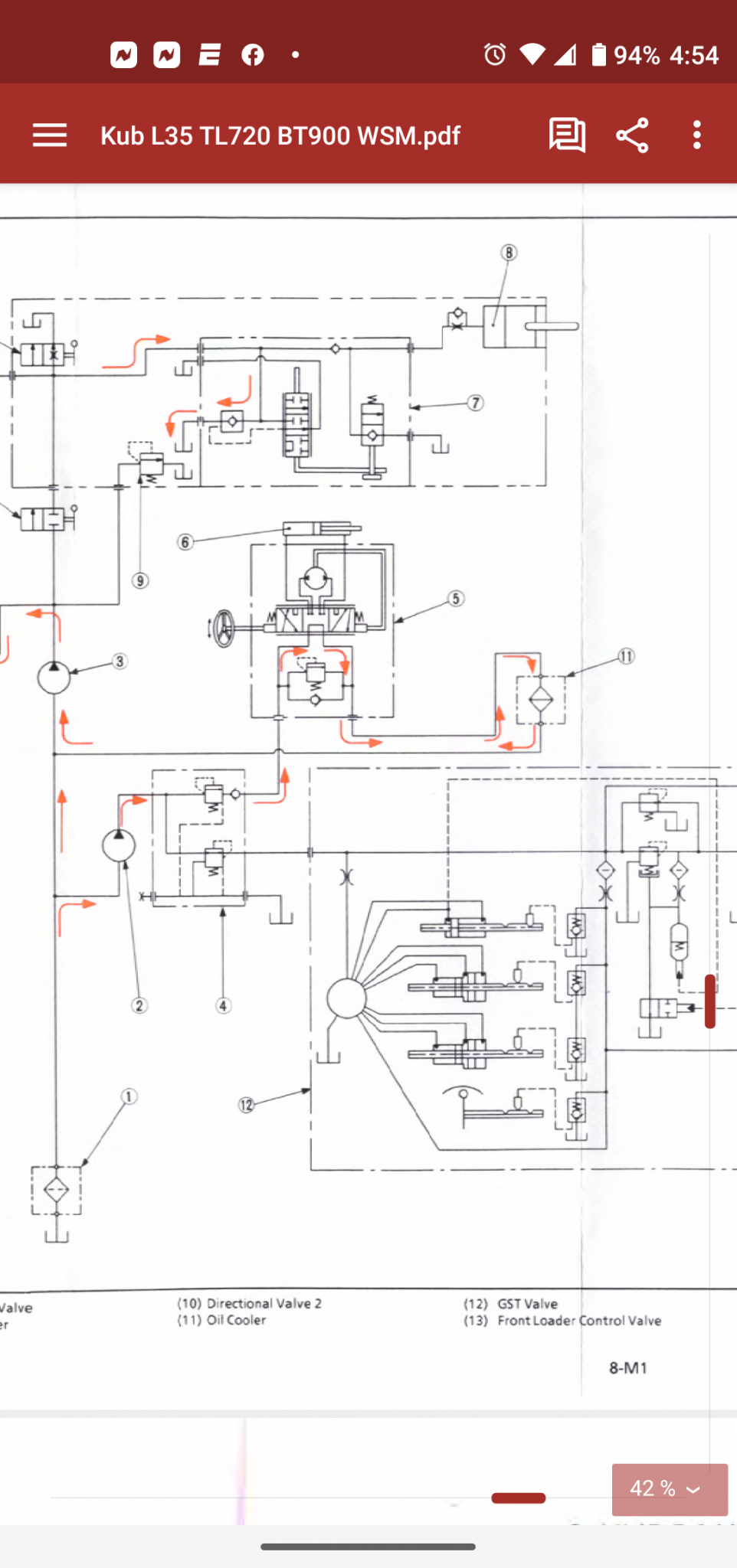

As you may be aware, there is a regulator valve in that pump circuit that gives priority to the transmission as shown below:
