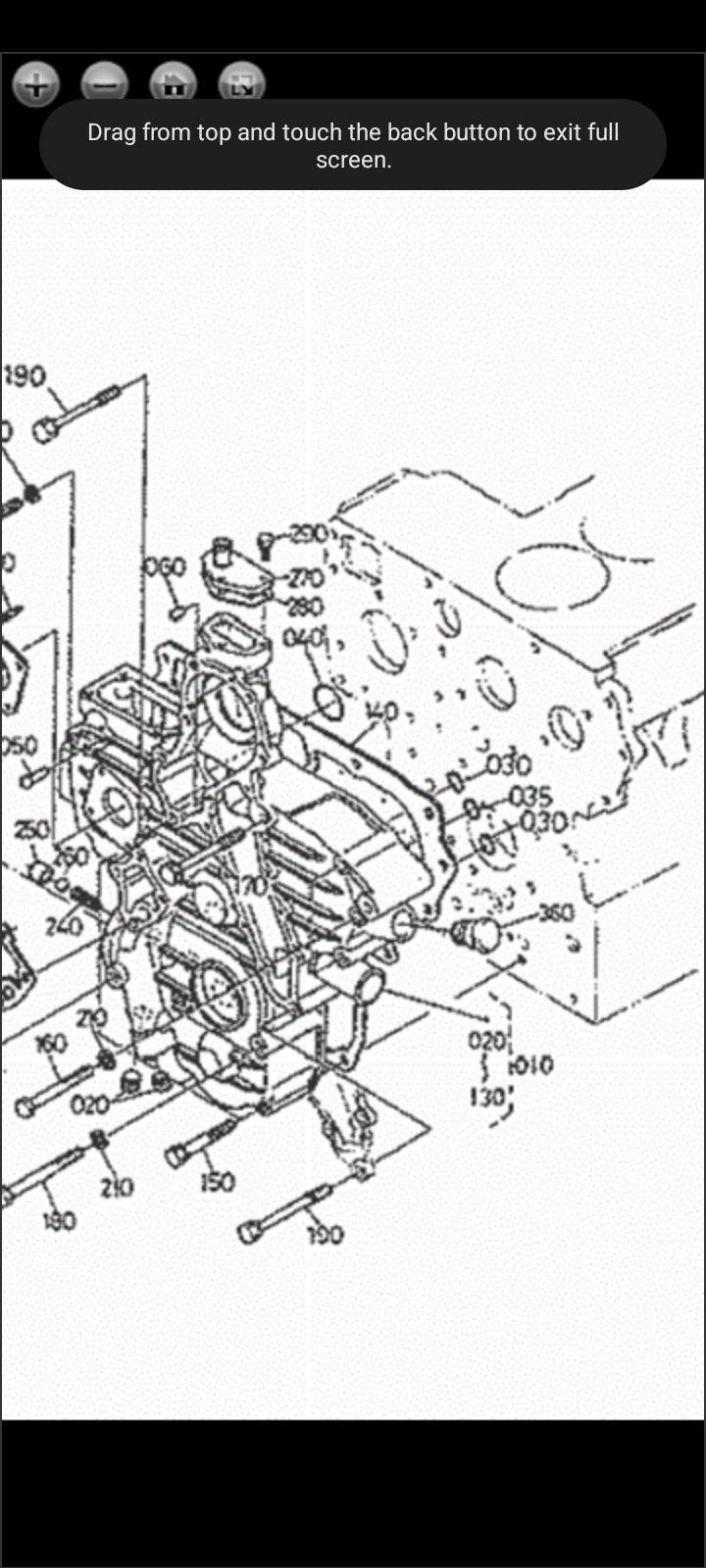

kubota l345 front engine case removal help
Calmachine831
Aug 10, 2018
20
Royal oaks
Because, like on many tractors, the engine acts is the frame. Everything else bolts to it.
I'm still wondering why the front cover needs to be removed. Isn't this engine being swapped out?
no engine swap as of right now. I inicially wanted to do a swap because my 4wd l345 has coolant in the oil. I thoughtva engine swap was easier and less work involved. Apparently these engine have a seal ir freeze plug behind the front engine cover which I think is bad.

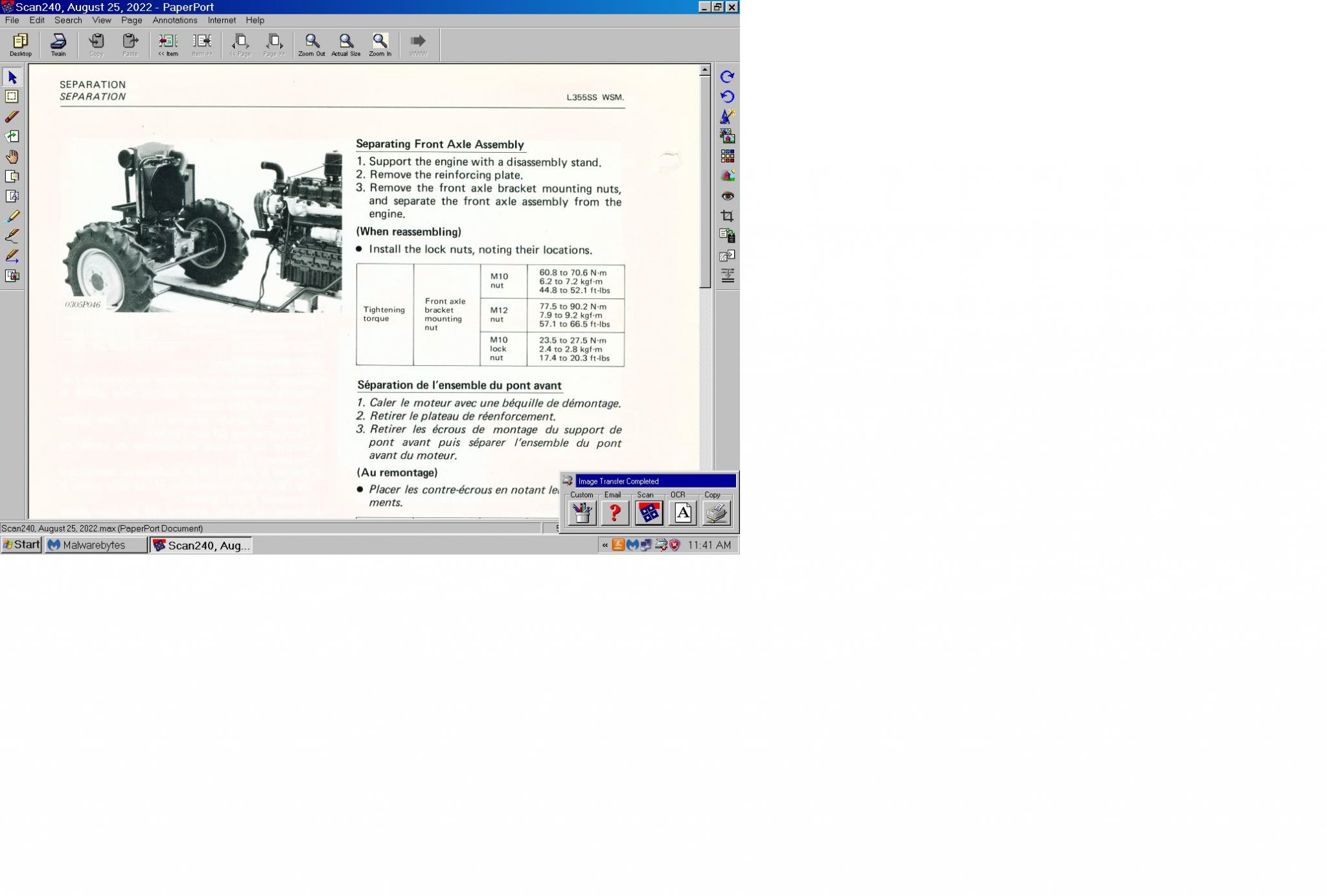

You can just remove the front axle and leave the engine attached to the rear end. There is no need to get the rear end off the engine to remove the pulley and front cover. Just hold the engine up and get the axle pulled away.

On all the early Kubota L models with 4wd, the front axle needs to come off to get the front timing cover off the engine. The axle and bracket can remain attached to each other and roll away once the front driveshaft and steering rod etc. are disconnected.
Here's a pic from the L355 manual showing the "split" at that location: (The thing on the floor is not part of the tractor)
