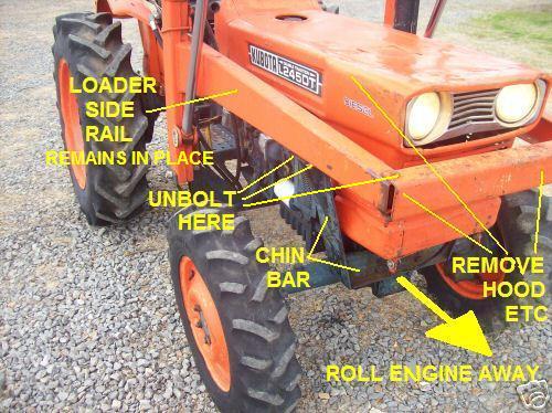

Swapping out the engine is some wrenching, but its quite doable. If the loader on the 4wd is the Kubota Model 1720, most of it can stay in place.
I've split L345 and L355 4wd machines with the 1720 without removing the loader. There's a front "chin bar" that has to be unbolted, and the front pump if it has one. The pump can be turned by an electric drill to raise the bucket if needed.
Edit: Here's a copy-and-paste from 2011 about a clutch replacement that covers taking the engine and front axle away from the rest of it:
To do the clutch the loader can stay on. We raised it way up and put wood braces in to keep it there. Took off the hood, drained the transmission oil, unhooked the hydraulic pipes on the side of the engine and all the cables & wires going from engine to firewall, took out the 4 bolts holding the loader side frames to the chin bar, took out the bellhousing and starter bolts, and hammered a couple wood wedges in to keep the front axle from tilting.
Next we put blocks under the transmission to hold the back end of the tractor up - and put a rolling jack under the engine for rolling away the axle and engine. Don't overlook unbolting the steering rod and the strut from the radiator support back to the firewall.
Once the engine and axle are detached, the axle can be unbolted from the engine.
Pic below is a smaller tractor but the idea for leaving the loader on is the same. go slow, plan your moves, work safe. Ask questions anytime. Have fun, Dick B
I've split L345 and L355 4wd machines with the 1720 without removing the loader. There's a front "chin bar" that has to be unbolted, and the front pump if it has one. The pump can be turned by an electric drill to raise the bucket if needed. Here's a link about clutch replacement that covers taking the engine and front axle away from the rest of it (wrong link - needs edit). Once the engine and axle are detached, the axle can be unbolted from the engine.

No - I'm in MA - I just edited post #5 write-up of procedure. Any questions - fire away.

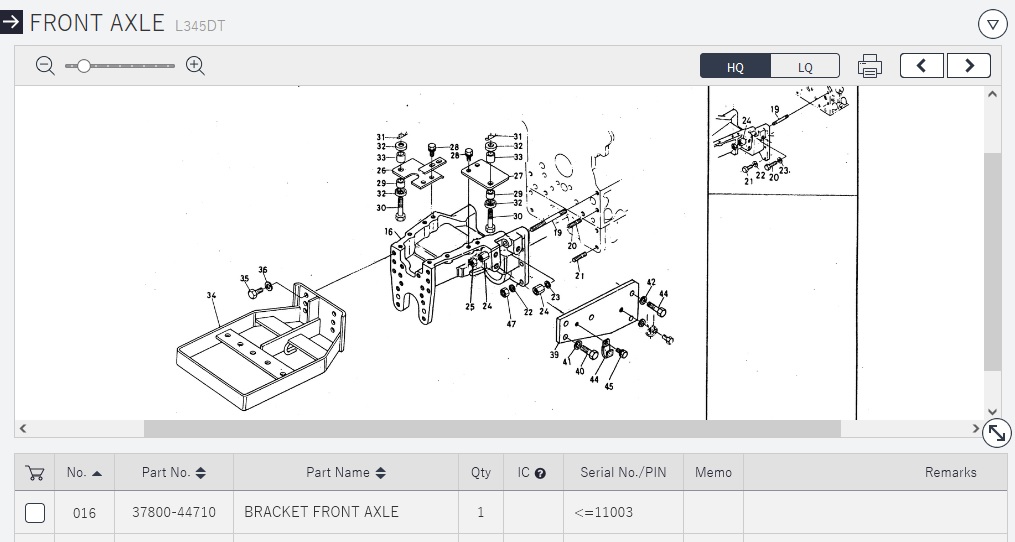

The axle can be taken away from the engine without "splitting" anywhere else.
There are several places along the length of the tractor where it can be split. The factory manuals refer to it as "separation".
One such place is at the rear of the engine (most often separated there for changing the clutch).
Another separation point is to take the front axle and the front BRACKET away from the engine (which can still be connected to the transmission). In your case the bracket will be transfered to the new engine so may as well remain attached to the 4wd front axle which is also being re-used.
For your L345's look closely at Post #5 above - with the loader in place it's lower support bar can be unbolted and the front axle and engine can be rolled away together. Then the engine and axle can be separated.
If you prefer, the engine can stay in place - the axle and the loader's lower support bar can be taken away with the engine still bolted to the trans.
With two tractors dismantled, you're going to have quite a pile of parts, but there should be everything needed to complete the changeover. Best luck. Dick B
I'm getting somewhat confused, I thought in order to remove the front gear case cover the tractor had to be separated(engine attached to axle and roll it forward). I just need to remove the front engine cover but in oder to to that I need to removed the pulley and the axle bracket is in the way. Not doing and engine swap if I can fix the problem with the 4wd l345 which has coolant in the oil which I suspect is a bad frost plug behind the cover. help appreciated thanks for patience

rbargeron
Jul 6, 2015
1,183
260
western ma
Now I get the plan - if you can fix the 4wd's engine, the swap is off.
On all the early Kubota L models with 4wd, the front axle needs to come off to get the front timing cover off the engine. The axle and bracket can remain attached to each other and roll away once the front driveshaft and steering rod etc. are disconnected.
