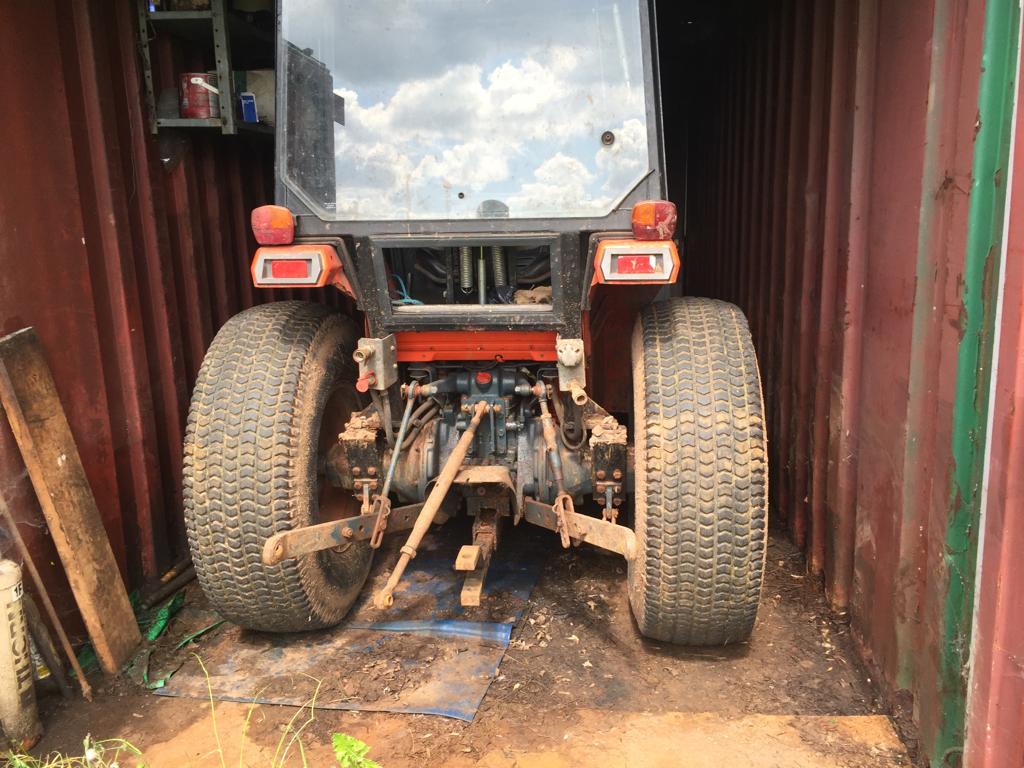

Hi All, New owner here. I have a L3250. Looking from the rear of the tractor , I have one Hydraulic point on the right hand side and two on the left. Would anyone know if any of these valves are the return or do I simply drop the line in the filler point? I have a 3 point backhoe I wish to attach. Thanks in advance.

The connectors on the left may be supply and return for an aux valve beside the seat. Where do they connect on the tractor ?

I will take a good look as soon as I can. The auxiliary lever makes sense. Ther is what i assume to be one by the seat. Thanks for the advice and I will, no doubt, ask some more questions when I have inspected. Many Thanks

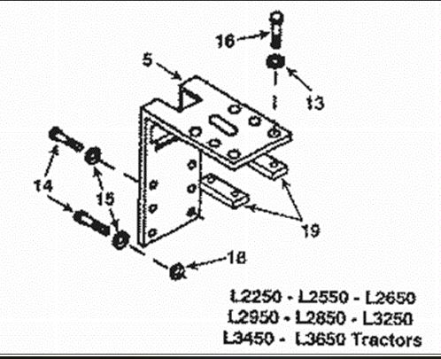

Word of Caution:
If your going to put a three point BH on it get the top link reinforcing plate!
Not doing that could cost you a ton of money as the three point BH's are notorious for breaking the top of the three point case.

I dont suppose you would have a pic or a diagram of such a thing would you please ?
