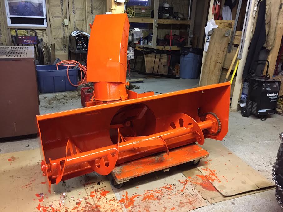

Big Orange
L3650 GST LA650A FEL Howse 60 inch bush hog, Kubota L 321 60 inch snow blower
Jan 11, 2014
Ripley, Maine
Sorry for the 2 posts its been a while and couldn't figure it out but got it now.
Thanks for the info, the gears are just like new and are readily available but for now not needed.
pretty much have all the welding done and ground it down and primed and painted. still looking at what I want to do for the chute rotator
thanks for the input.
