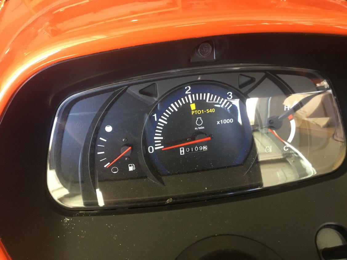

One thing that confuses me, is why would there be a rated (2600) PTO RPM marker on the Tachometer, and a maximum (2900rpm) PTO RPM marker 300rpm higher? My machine revs just over 2700rpm maxed out.
Any ideas on that?
Does the L2501 have something similar?

What model tractor is that dash on?

NIW, that is the dash of my 870.
Rdrett, apologies for jacking your thread, but I felt it was along the same lines of info you are looking for.

Mine doesn’t have the max and rated.
If I had your machine I would have no problem turning up the rpm to 2900 rpm.
It clearly says 2900 max so I would crank it up.

I'm guessing the "MAX" marker is what we used to call the "Red Line" for max engine RPM?

I thought so too maybe. But, why is it PTO related, with the PTO symbol? I wouldn't think the engines max RPM would have that symbol.
Hmmm... looked at it again. Not sure if it's PTO or not.
I see what you're saying with the 2 PTO symbols...
My experience with JD are a Styled B circa 1940, and a 1996 425 Garden Tractor.
Your 870 is Asian or European, if my memory serves.... I'm honestly not sure what the heck they were trying to say with that indicator! :( I'm wondering if that was their attempt at a Red Line and it was confused in the "translation" or presentation on the dash?!?! I don't know - just guessing..
Like I said before, I know that some of Asian manufacturers knew how to put an honest "red line" on their motorcycles..
It's built in Japan. It's technically a Yanmar, built for John Deere, by Yanmar.
The 3TN84 (when in the 870) has a governed/limited high idle RPM, of 2750-2800rpm, I'd think that would be where the "redline" would be, if it were marked, maybe(?). Looking back at the second PTO MAX marker, it actually appears to be 2950rpm, judging by the spacing of hashmarks.
It's confusing. Could it be the no load PTO rpm is MAX, and the loaded rpm is RATED?

Any idea what the min-1 (rpm), means?
8,121
3,199
Yes that is one way to state “per minute”
The Max pto your dash shows is just a limit on engine speed to limit the pto to some rpm. Rated would get 540, max would get something like 550 to 575 rpm
