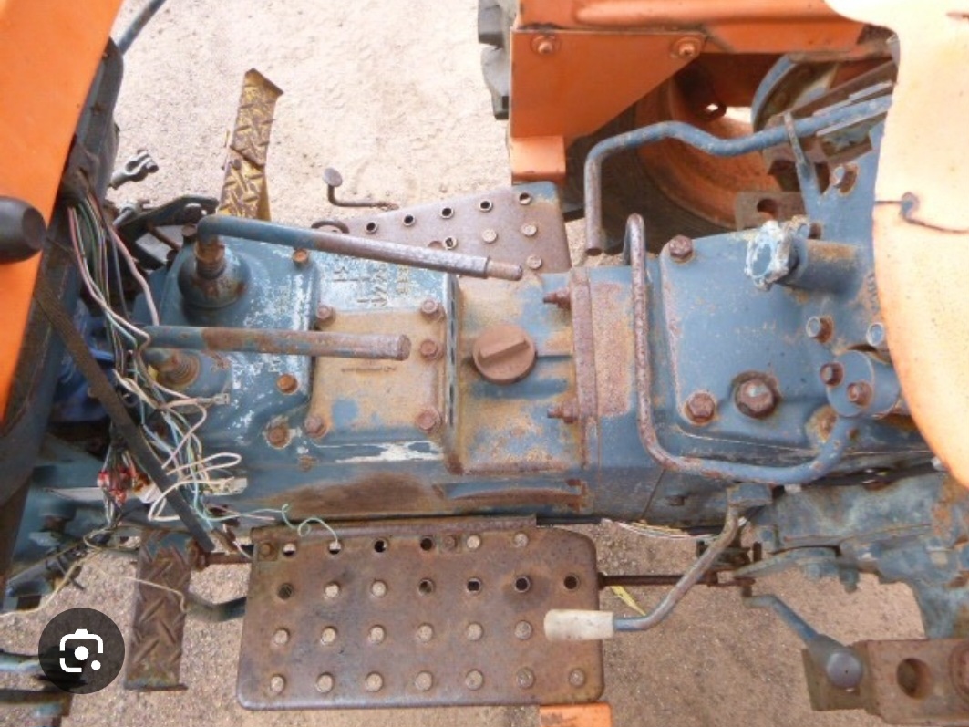

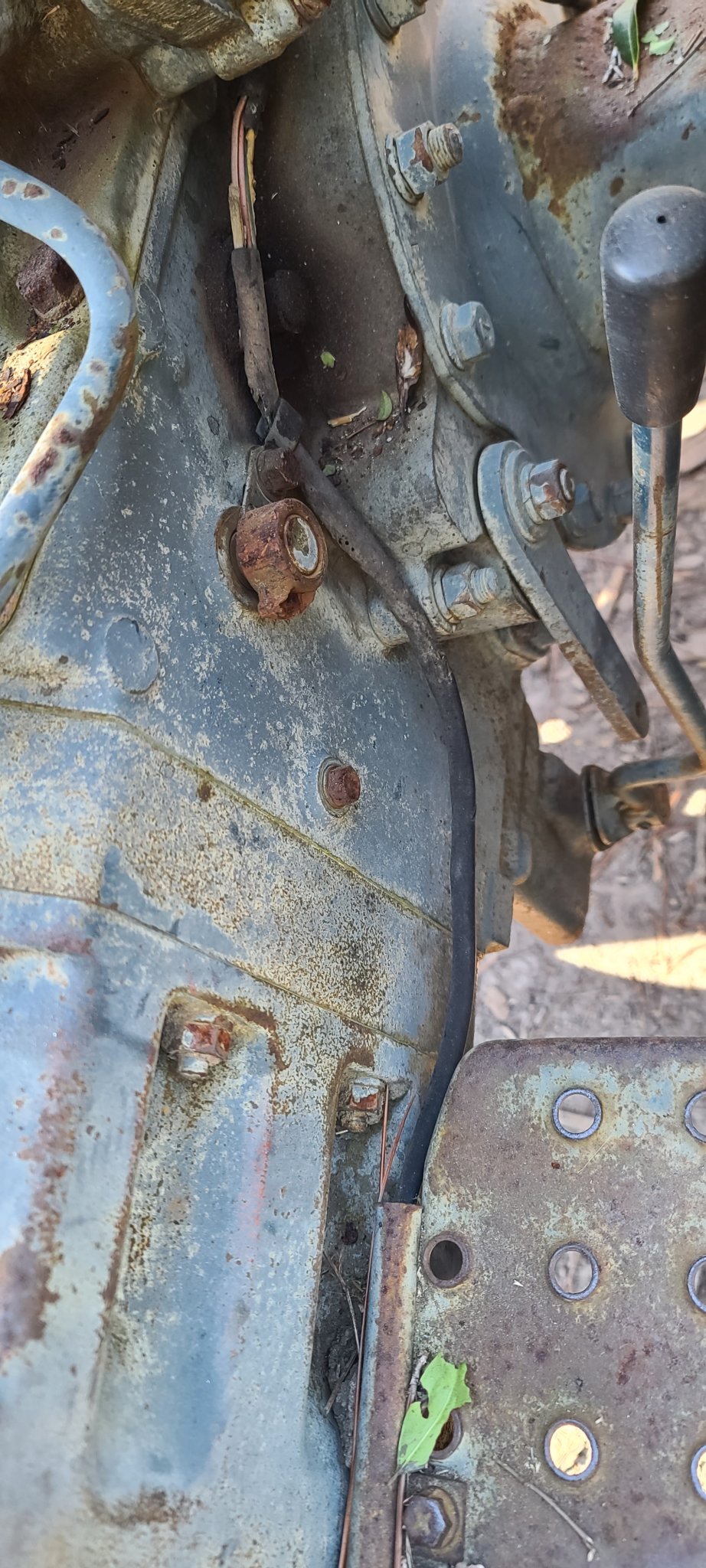

You won't even believe it but the high low was in neutral grrrrr. There is no markings or lever on mine just a nub. First picture is my tractor with no levee and second pic is how it's supposed to look. I have no clue how it got into neutral.
But now the pto goes sometimes and then sometimes it won't go unless I take it out of gear and let off the clutch then it restarts and will go for a while then just randomly stops. Low on transfluid ?

Send me a message with an address and I'll send you a high low lever. Why did you put a clutch in your tractor to start with? These tractors have a one-way clutch on the PTO. It is at the back of the transmission inside. They do fail. Not very often.
